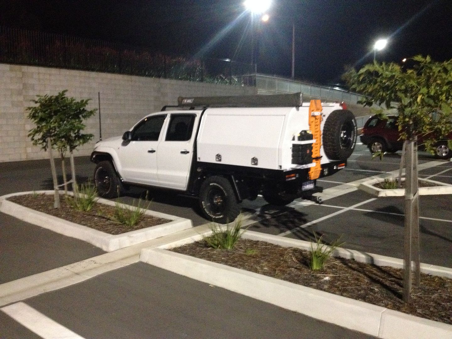

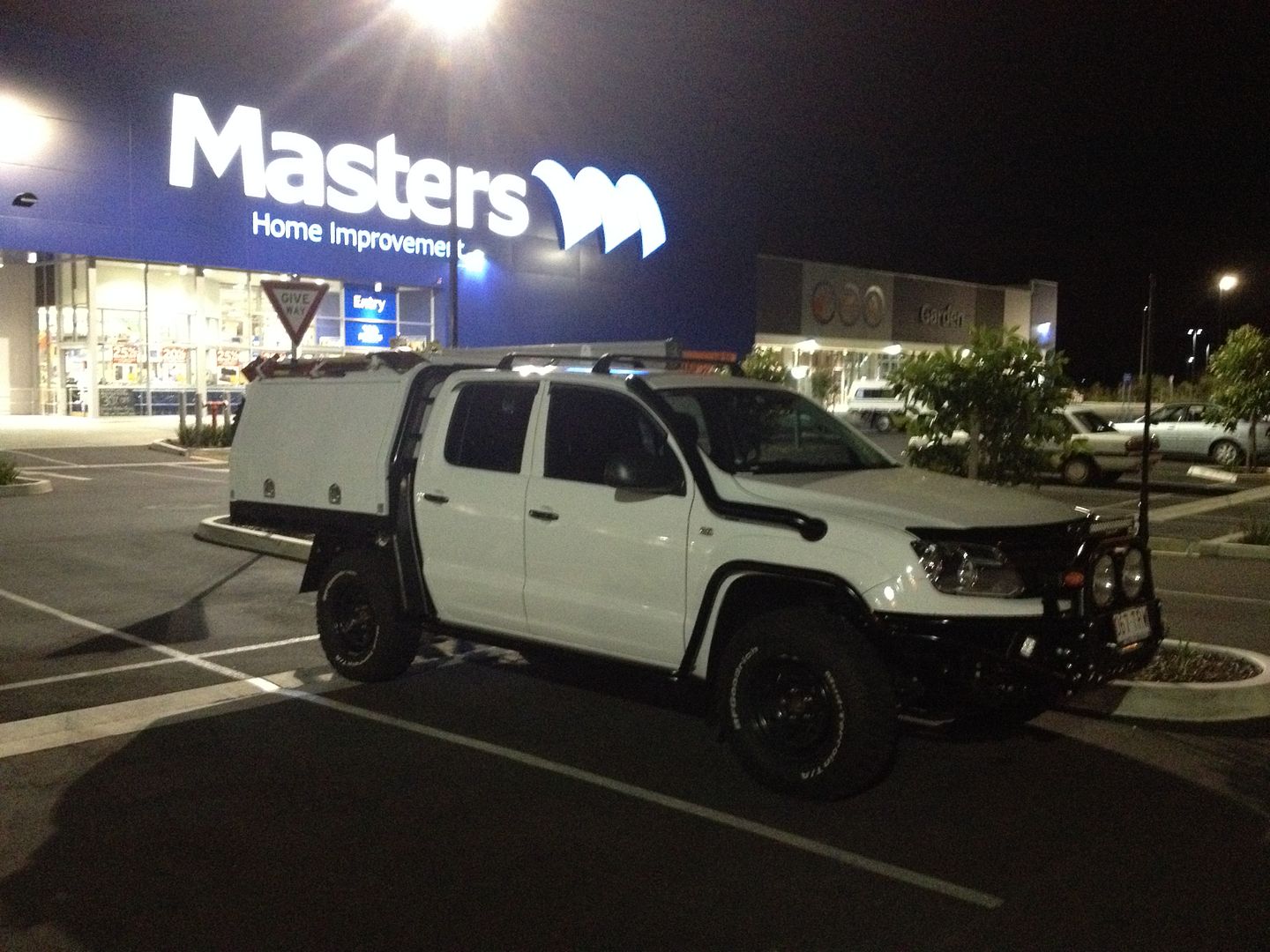

And guess who forgot to take pictures, very busy at the moment. Took a few but the quality isn't great due to night photos but beggars can't be choosers.

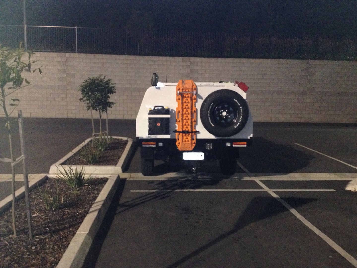

Bet you can't guess where this was taken. They really should have better signage.

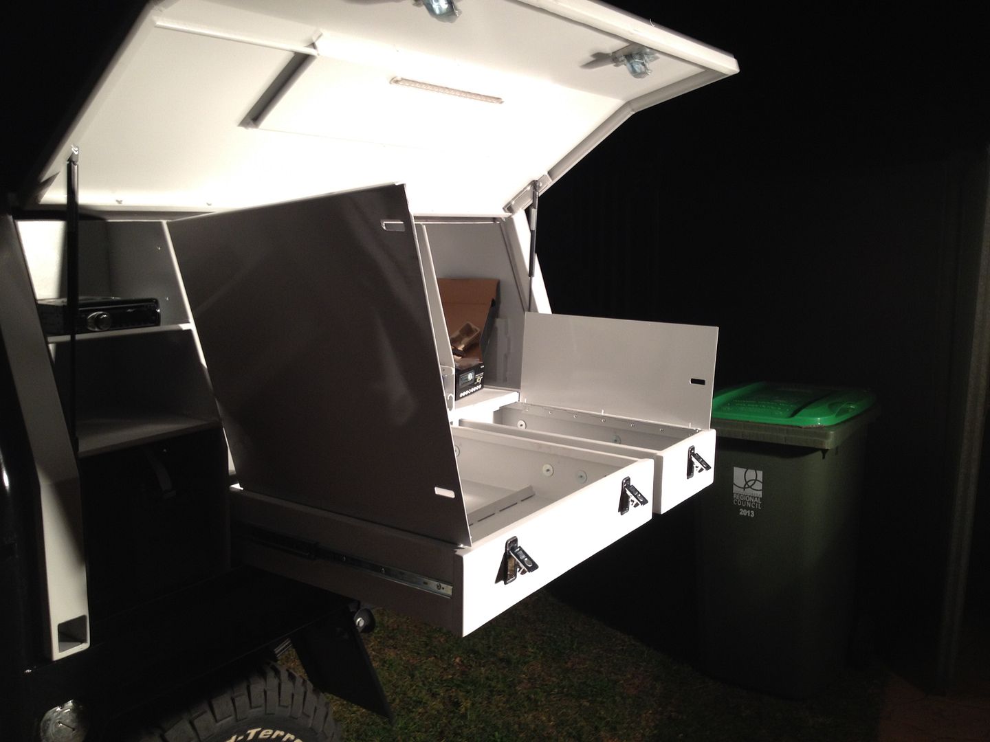

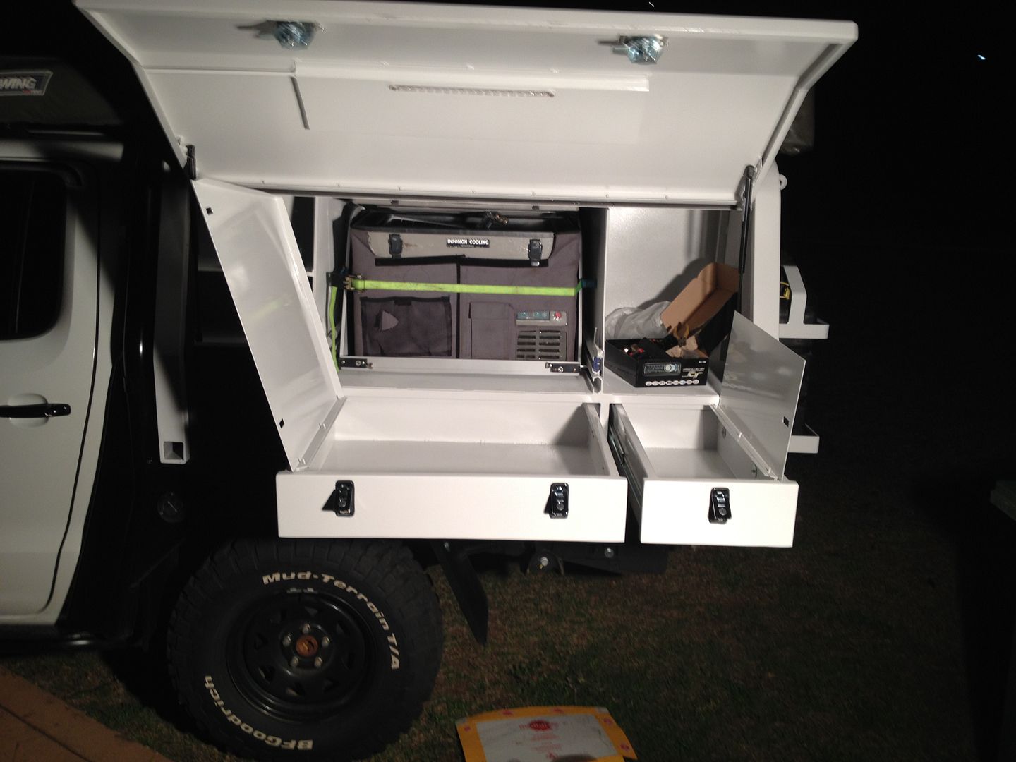

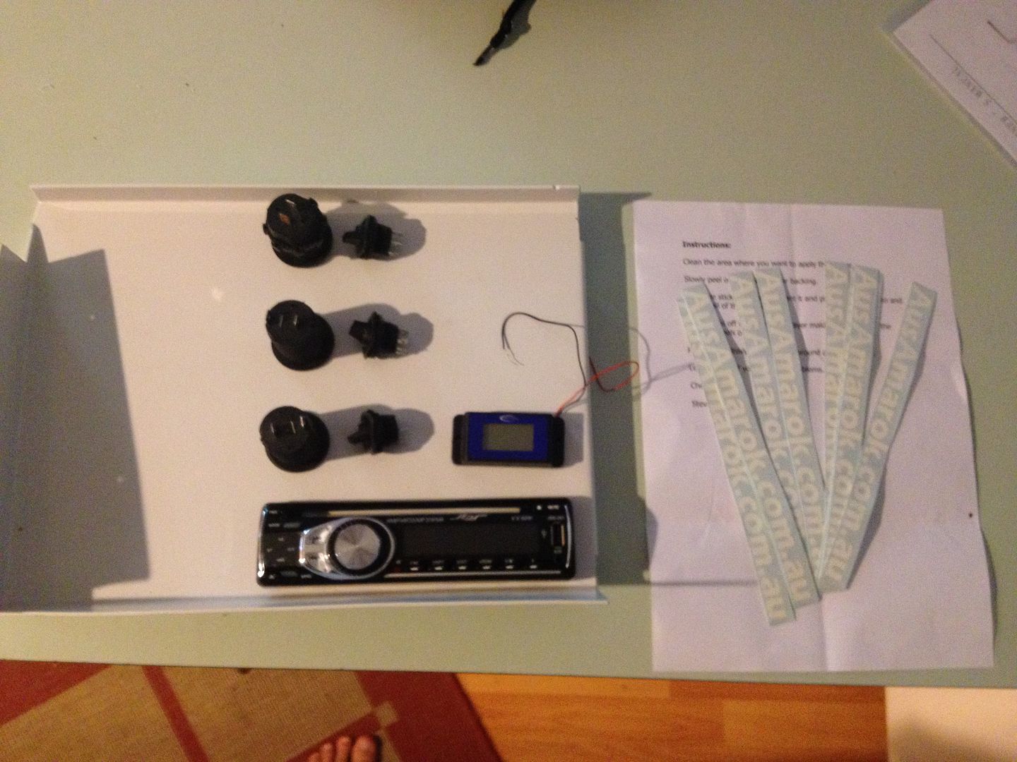

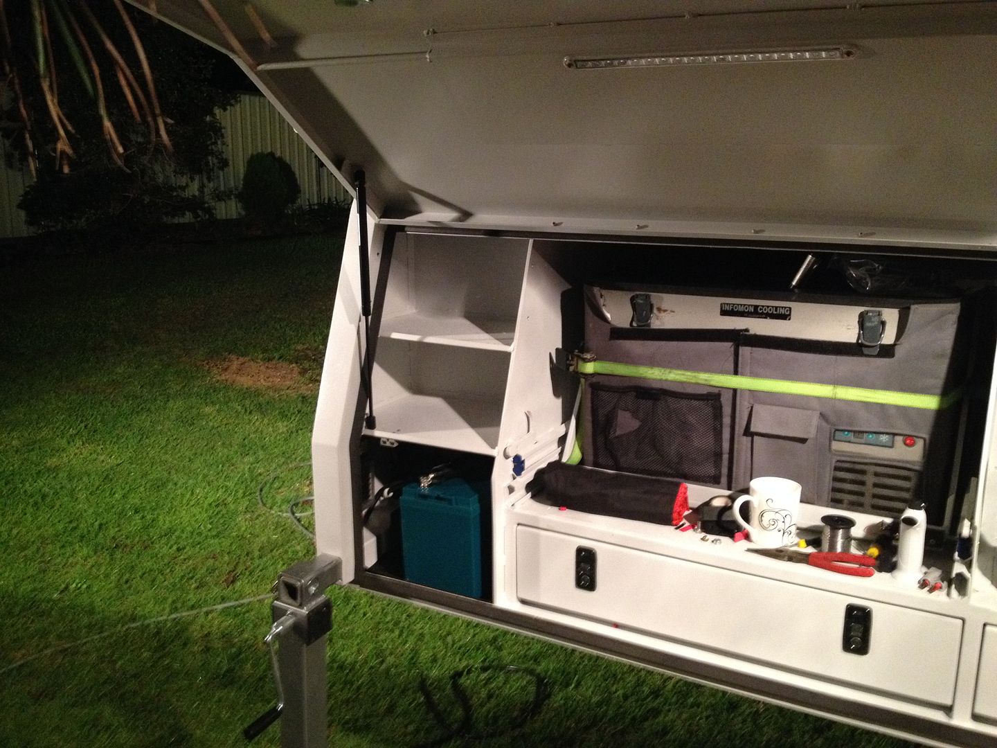

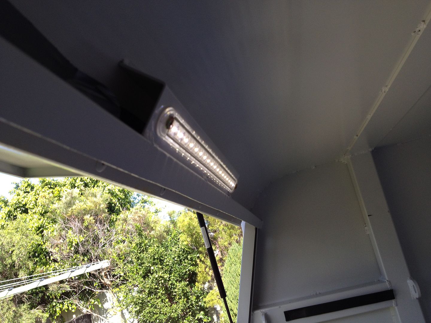

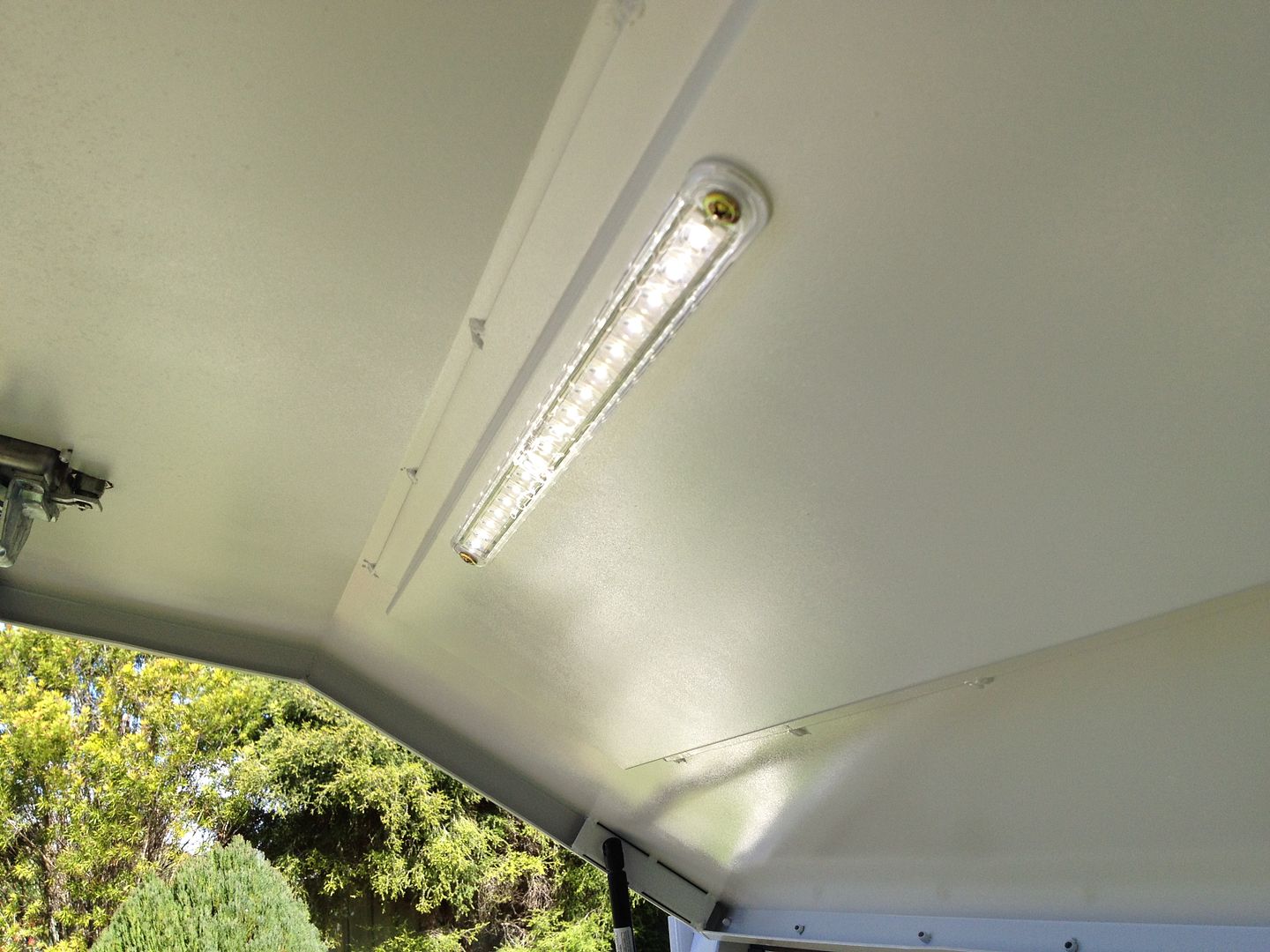

Mocking up electrics. Can't stress enough how important putting something in place, walking away to think, grab a beer, coming back, staring, rearrange and then sleep on it is before getting the drill out. Long process but the outcome will speak for itself. For those playing at home that is an led strip on the door.
Draws, damn they're sexy.

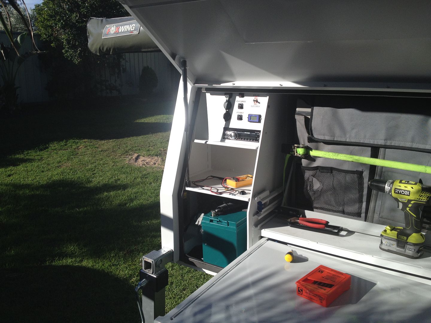

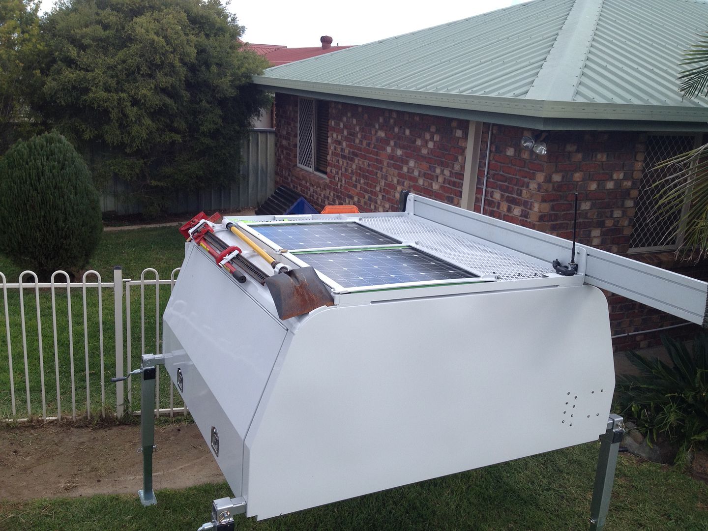

Anyho getting to the finicky part now starting to mock up the electrical panel and doing all the wiring.

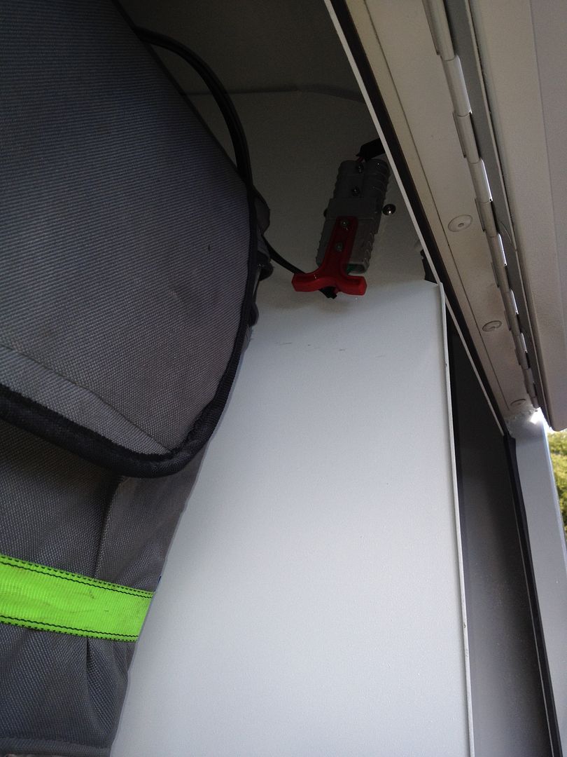

The aerial is for the stereo I am running in it, just in case I feel like listening to the radio round the campfire. Have set the canopy up so it can be independent of the car, bit hard to see but right beside it is a waterproof Anderson plug that connects to the 2nd battery under the bonnet just in case I need to charge the whole system up.

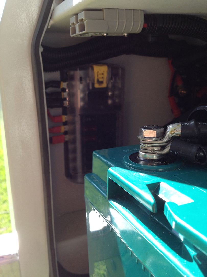

Hidden Anderson plug that's runs the fridge, don't know how anyone runs those other stupid little plugs for fridges, they work ok when stationary but once you start bouncing around they ain't so good. Mine lasted standard for two months got the ships and changed it to Anderson, lovely.

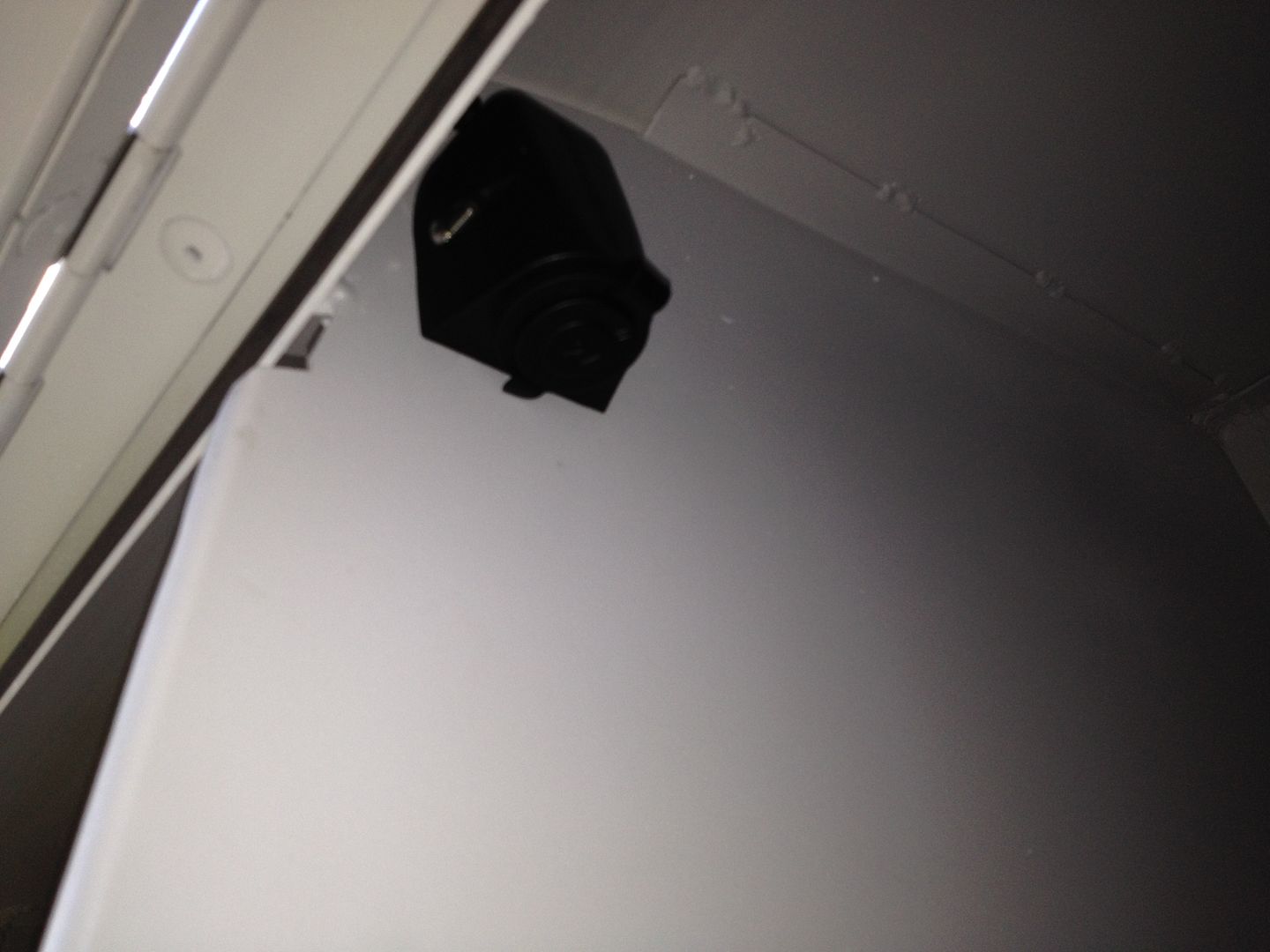

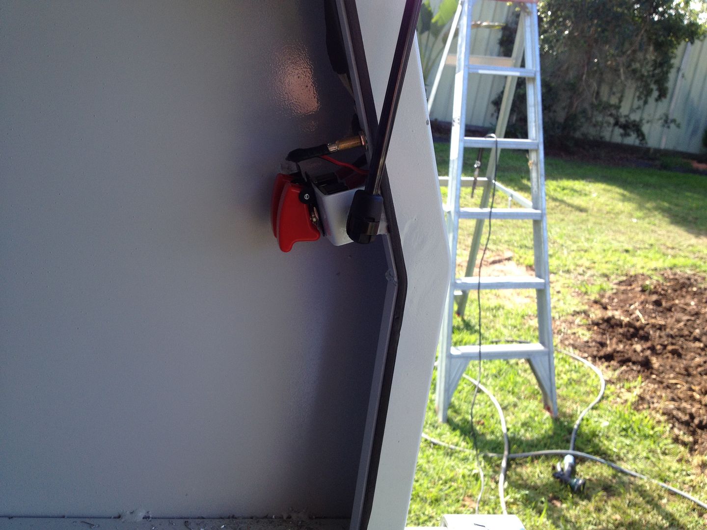

Here's the auto switcheroo (technical term) that turns the door light on as soon as the door opens.

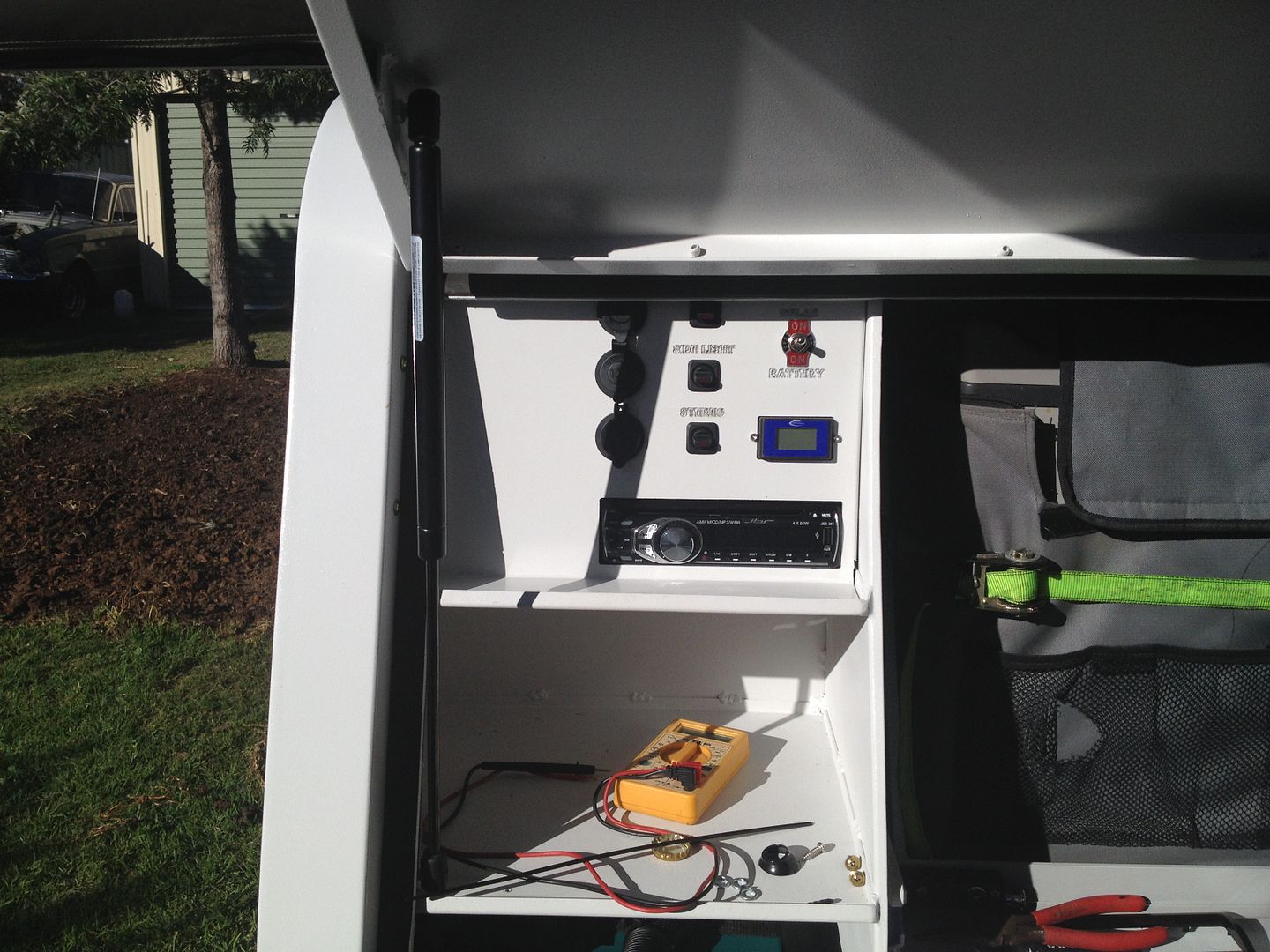

A couple of manual override switches as no one backs baby in a corner.

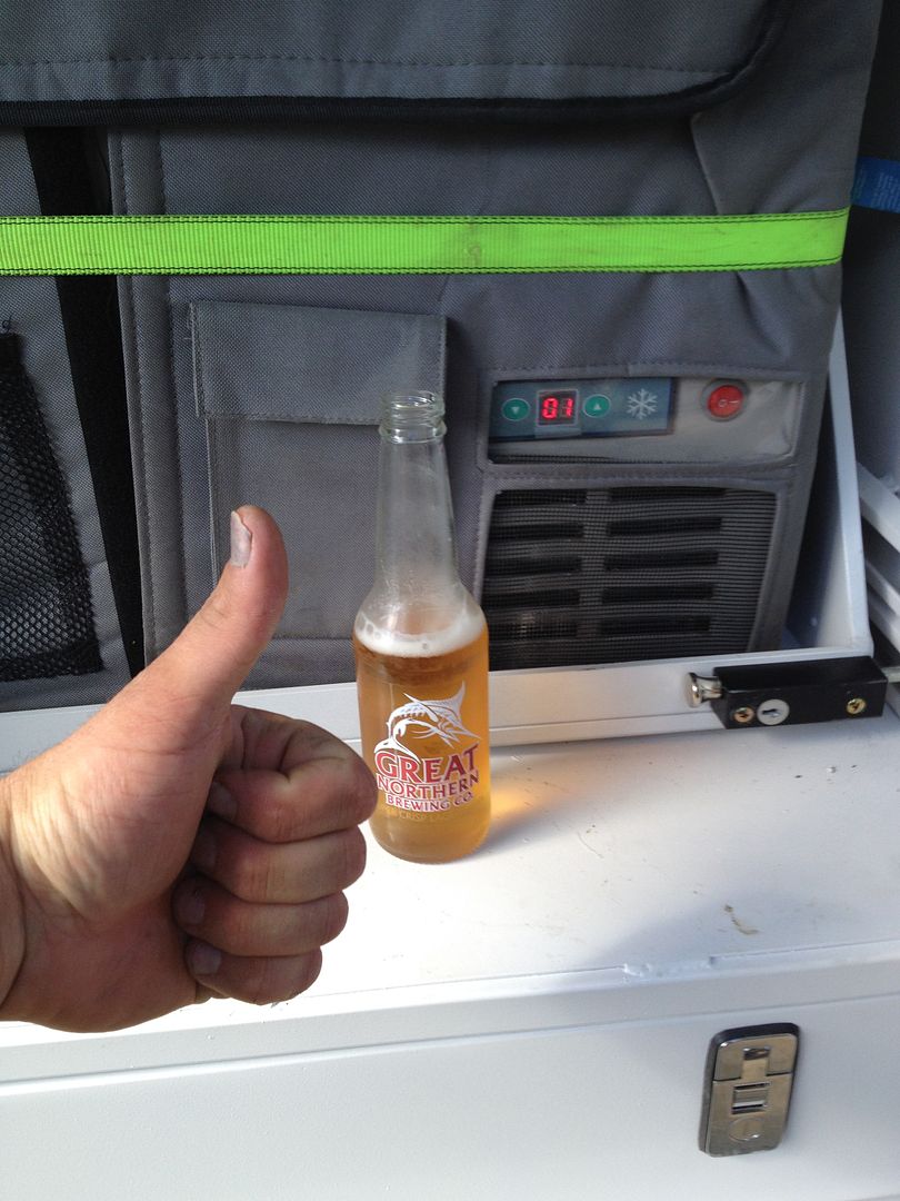

Have been running my fridge at 0 (it bounces between -1 & +1) for 24 hours with the solar panel running, it's having no probs keeping up.

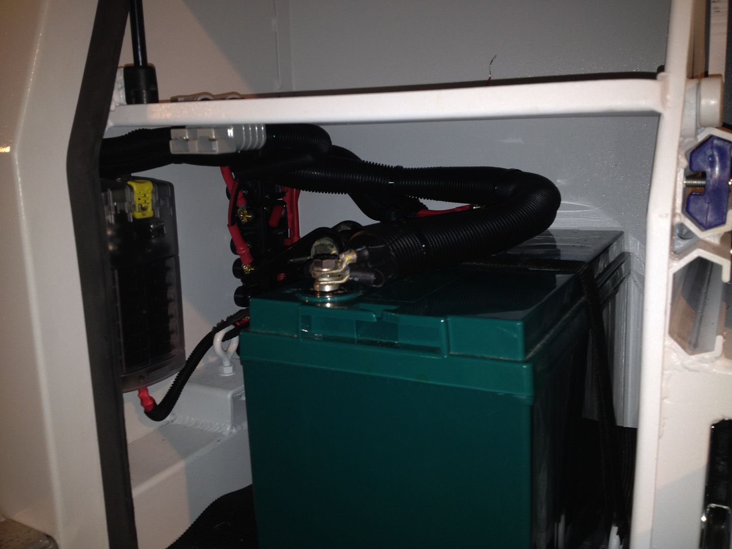

Starting to use the fuse block.
And finally my favourite modification tool.

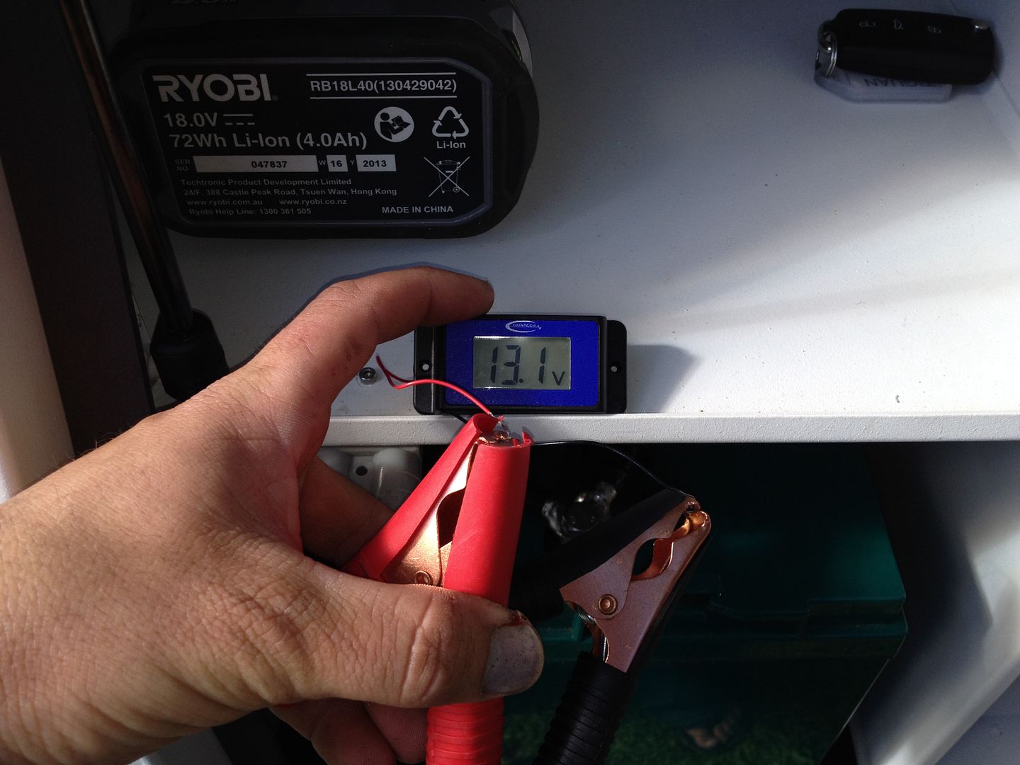

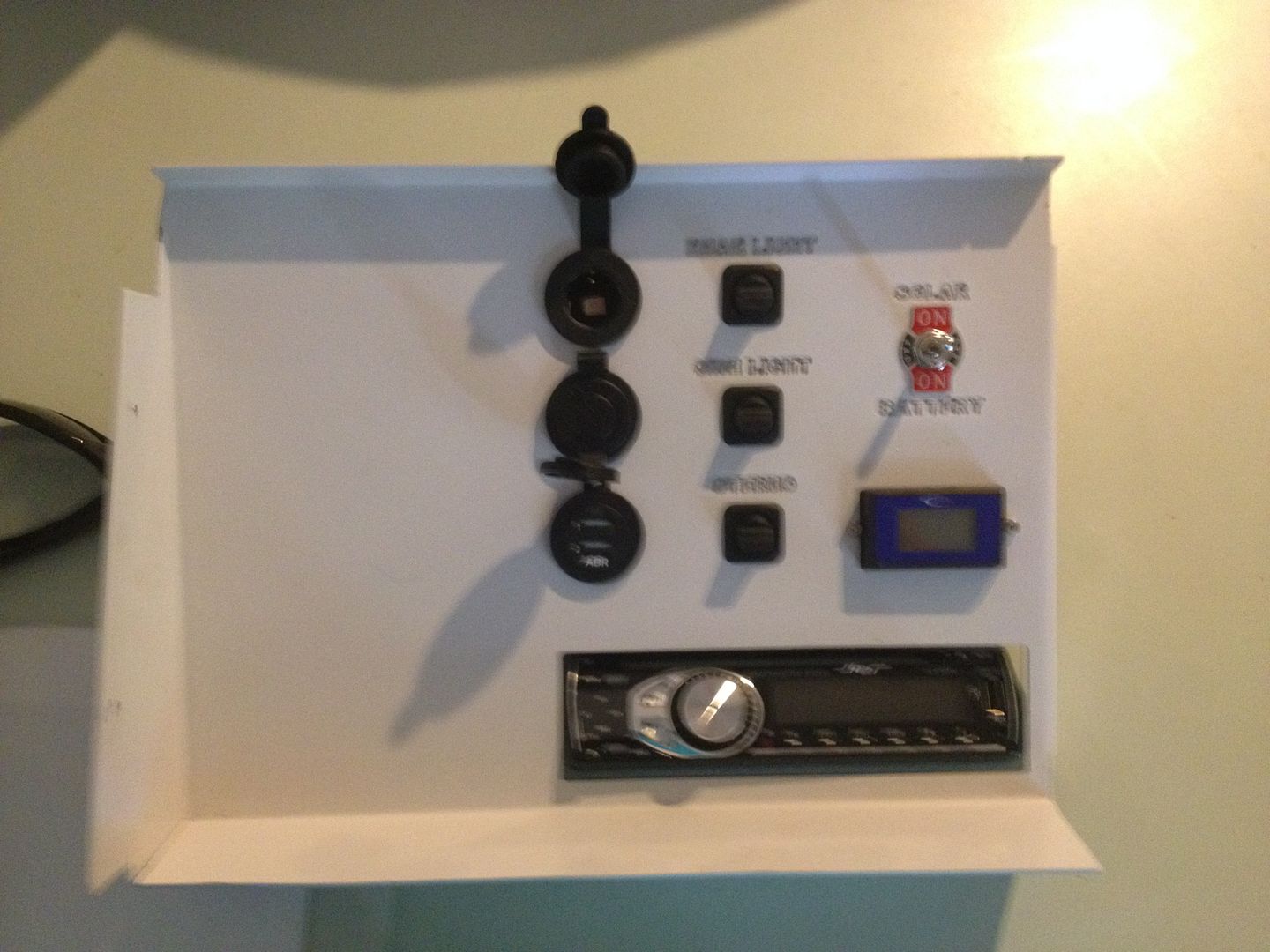

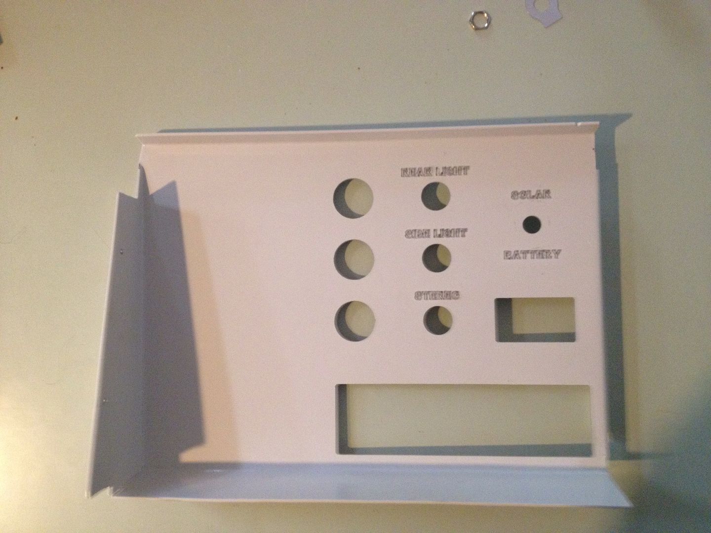

Two cigs plugs, two USB chargers, the fast ones (iPhone, iPads etc quick chargers), switches for rear lights, side lights and stereo. Then a switch for seeing either solar voltage, or battery voltage. Then the stereo.
