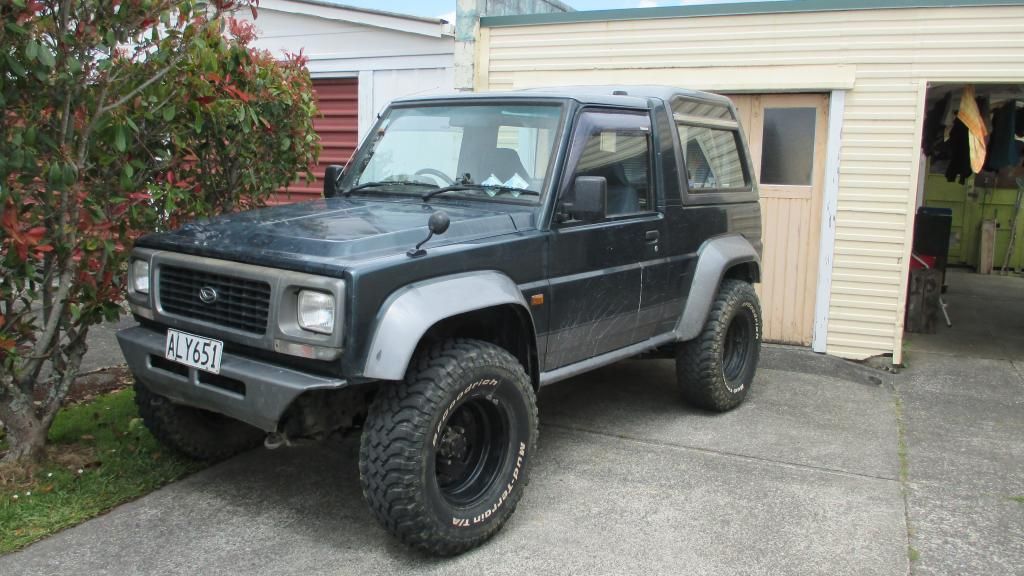

Unread post by NZRocky » November 27th, 2014, 11:43 am
She's looking good! I speak from my own experience when I say 33's are a tight squeeze on these wagons, you will need a 2" body lift if you don't want to cut up your guards.
