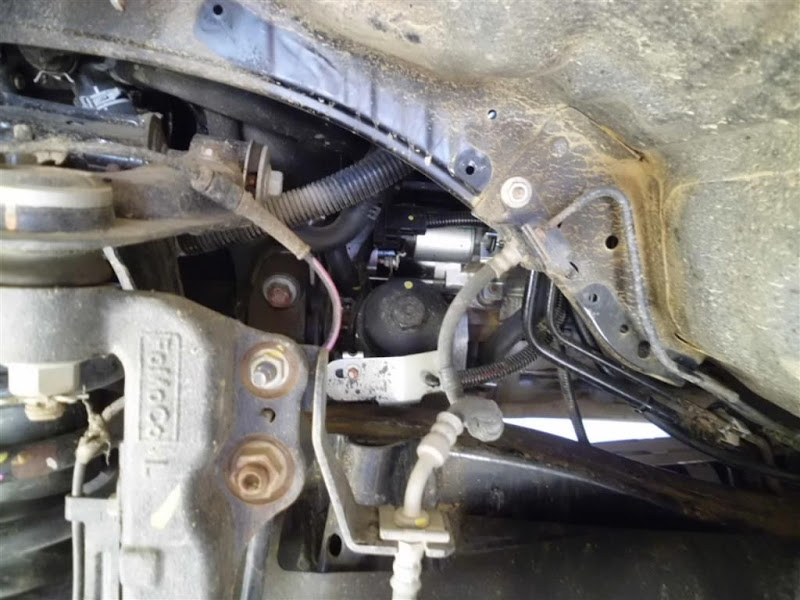

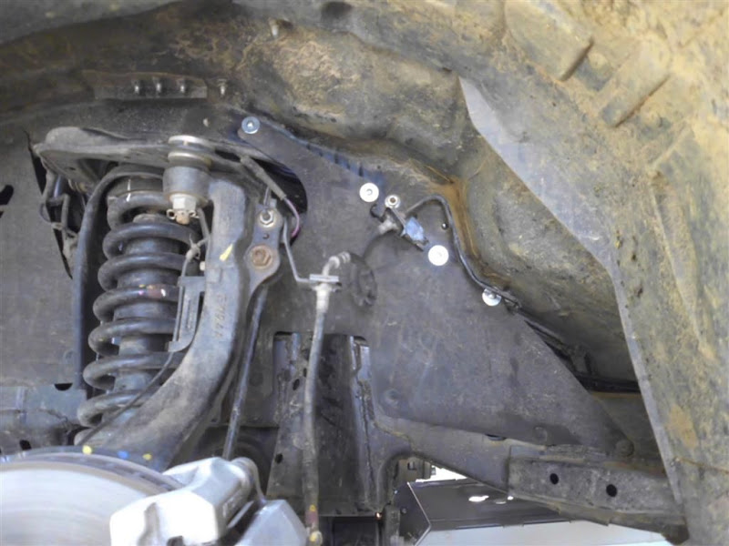

I don't plan to do the engine oil change until later, but later could actually be on the road on our upcoming Simpson trip, so I wanted to get organised. The drain system above is part of that, and the next bit is to figure out how to change the filter. I got 10 packaged with the vehicle, so that bit is under control. Also got some air and fuel filters, so all receipts for genuine consumables in case its an issue later.
I spotted a reference in one of the threads to accessing the filter through the wheel arch, and a quick look indicated that it looked promising. Its a long way down from up top, and my Waterwatch and breather extensions restrict access that way a bit too. Perhaps possible from underneath, but tight.
Wheel removed and the plastic panel is easy to see, held in by the usual expanding plastic clips. Two rows, one on the chassis, and the other on top on the body.
I removed the top four clips and the panel folded down out of the way, exposing the filter housing nicely. Some rags underneath and a 6 point 27 mm socket and it should swap out fine. And you probably only need to remove the top 2 clips to get enough access, maybe.
I then put four nutserts into the holes.
After filling them with some antisieze, the panel is back in place. Four 5 mm screws with a small spring washer acting as a spacer to match the thickness of the panel, and some mudguard washers. It is a mudguard after all :rolleyes: With short screws that don't protrude through the nutsert, and the antisieze, the threads should stay OK and it'll facilitate filter changes.
Looks like it might be accessible OK without wheel removal too, perhaps on full lock. Not too big a deal for me as I plan to rotate all 6 wheels each service anyway.
Is it me, or does anyone else think that some of the wiring under here looks a bit vulnerable?
