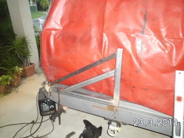

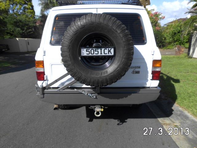

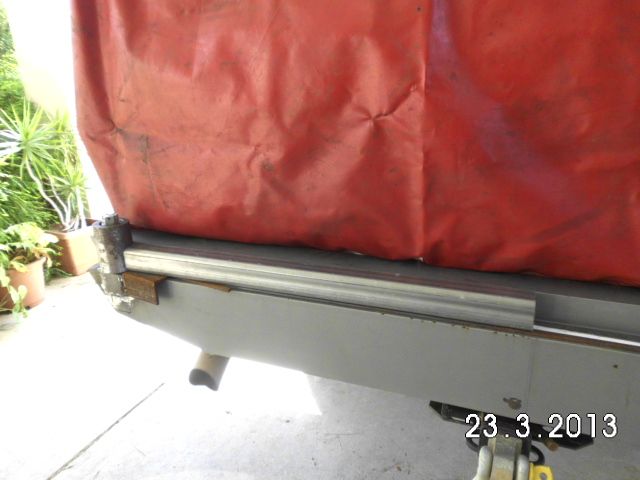

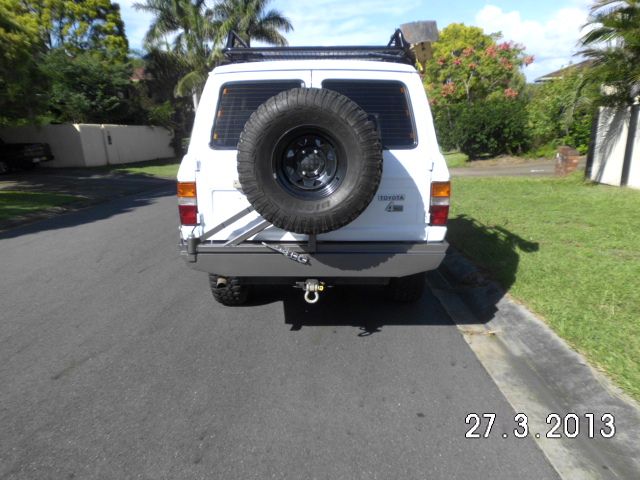

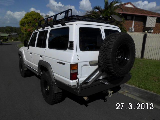

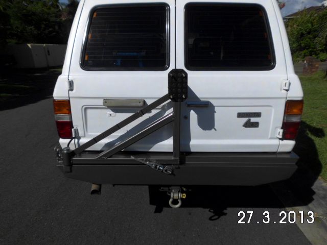

spent the weekend finally building my spare wheel carrier and I reckon it turned out pretty good but I am biased :D
the finished product

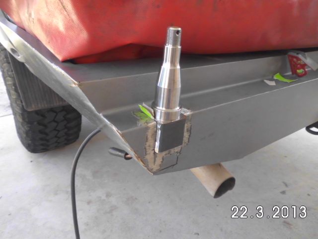

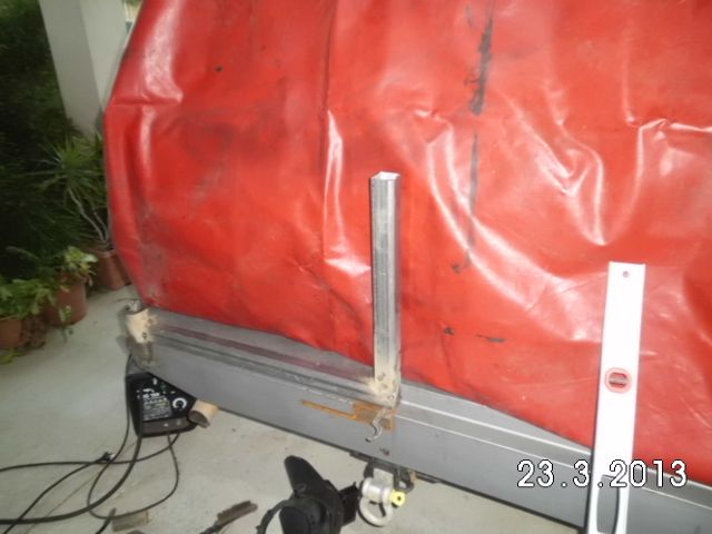

and the journey . because I only had an idea and no plan it was a case of cut and tack weld one piece at a time
first mount the stub axle
then

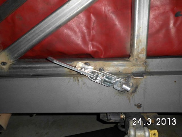

I mounted the clasp like this coz I read it on another thread and the idea is it pulls down as well as sideway's to keep it al firm and tight with no rattles

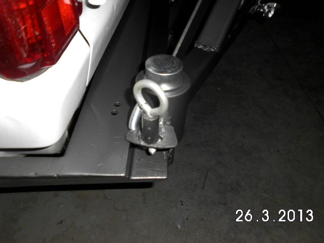

I'm pretty happy with the homemade springloaded lock to hold it open . I tried buying something but couldn't find one
my welding is still below par for neatness but is improving but the penetration is excelent so should be strong as
cheers Mark

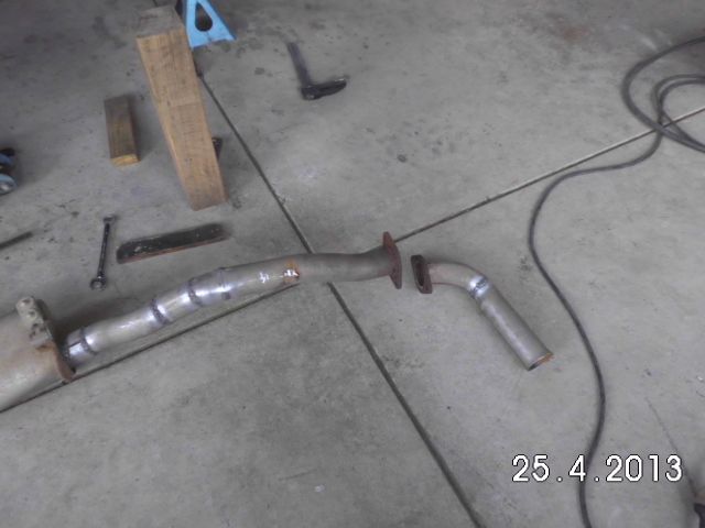

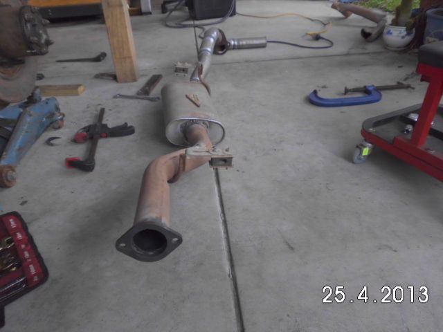

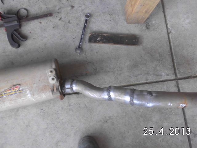

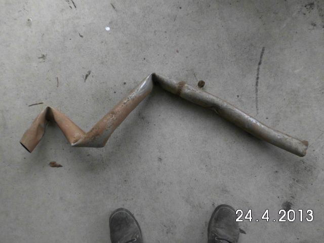

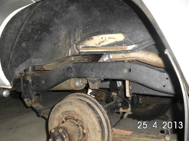

another casualty of the easter weekend was the exhaust pipe this was my tail pipe

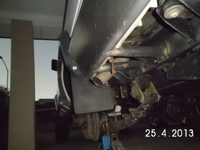

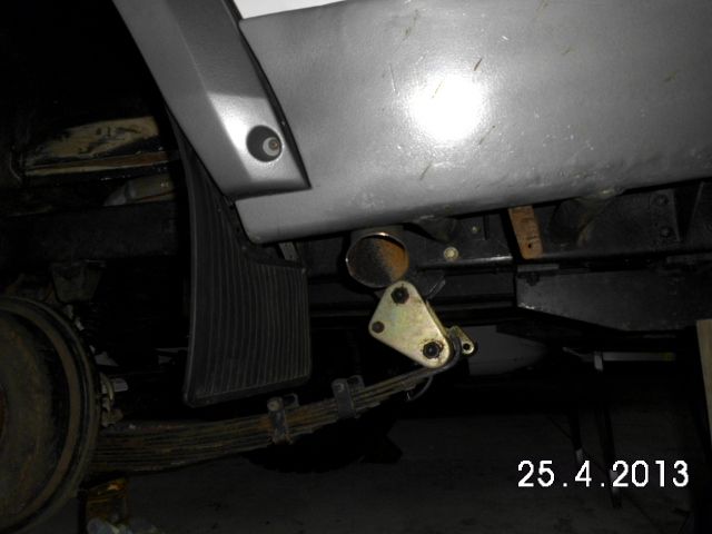

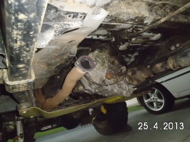

i had to cut it off at the tracks as you can see she wasn't breathing very well lucky my mate had a hacksaw , I now carry one . I got a quote from Midas $280 for a new tailpipe fitted so I went to the wreckers and paid $22 for a couple of peices of 2 1/2 inch pipe and spent the day adjusting it to suit . I decided to run it over the chassis and out behind the back tyre to hopefully avoid future squashed tailpipe (yes it's a regular occurance) there was a fair bit of cutting and welding cos I don't have a pipe bender but I'm pretty happy with the result anyway some pics first the new pipe you may notice the joiner plates there's now 3 peices which makes life much easier
the new route
and the new exit point
and as an added bonus I can now grease the greasable shackle :D
oh yeah and where I put the front joiner
cheers Mark
