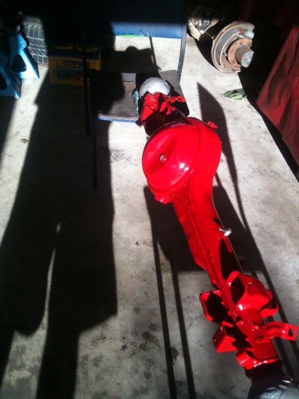

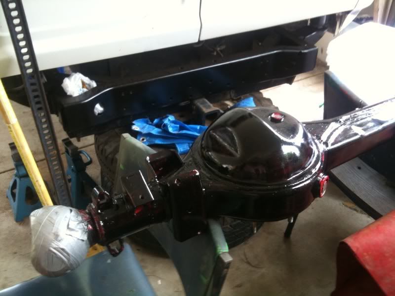

Diffs.
this is the actual important job that needs doing I have the diffs and am going to replace everything brand new bearings seals steering hub kit tie rod ends uni joints and full suspension but I keep stalling buying the bits you see I can get them from ebay pretty damn cheap and they promise all japanese bearings no chinese but each section has a kit but no acurate list of what's available and having not done this before I'm not sure of exactly everything I need :confused:
I should just go to a reputable part dealer like opposite lock and let them get it all for me but that works out a fair bit more expensive. oh what to do. the other problem is the diffs are from diffferent vehicles the front is from a 1989 hj61 and the rear is from a 60 series that's all I know . no idea of year or origin and apparently something changed in 11/84 and the kits are different pre 84 has a solid spacer and post 84 has a collapsable spacer but I don't know what spacer they are talking about so I can confirm what year it is :confused:
anyway that's basically why I've been putting of doing the diffs. I know I'm just being slack .
so all I have done on the diffs is cleanem up a bit in preparation
front diff undercoated in killrust red
my son said to leave it red he reckons it looks ace but i painted it black anyway
it still needs another coat of black that's what I'm going to do thisarvy when I finally get up from this damn computer lol Oh and the back housing is also at the same stage (no pics).
I really need to pull my finger out here coz I bought a brand new ARB air locker of the forum for a good price and it should arrive early next week and I want to put it in the back and then I will try and source an auto locker for the front when the funds are available.
ANY OFFER OF HELP WITH MY DIFF DELEMA WOULD BE REALLY COOL :thumb:
cheers for now
Mark
