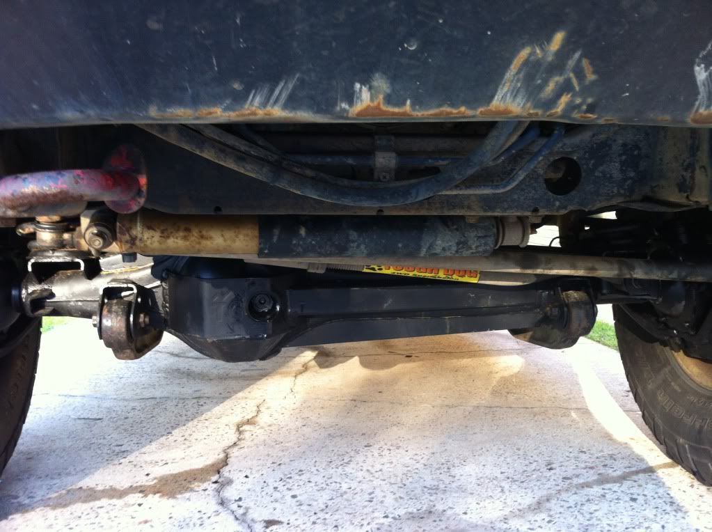

A very naked 80:

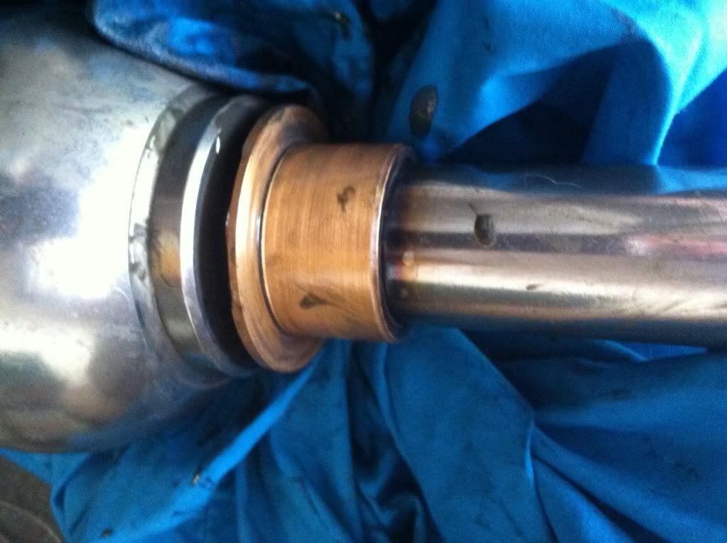

One of the brass bushes found a new friend:

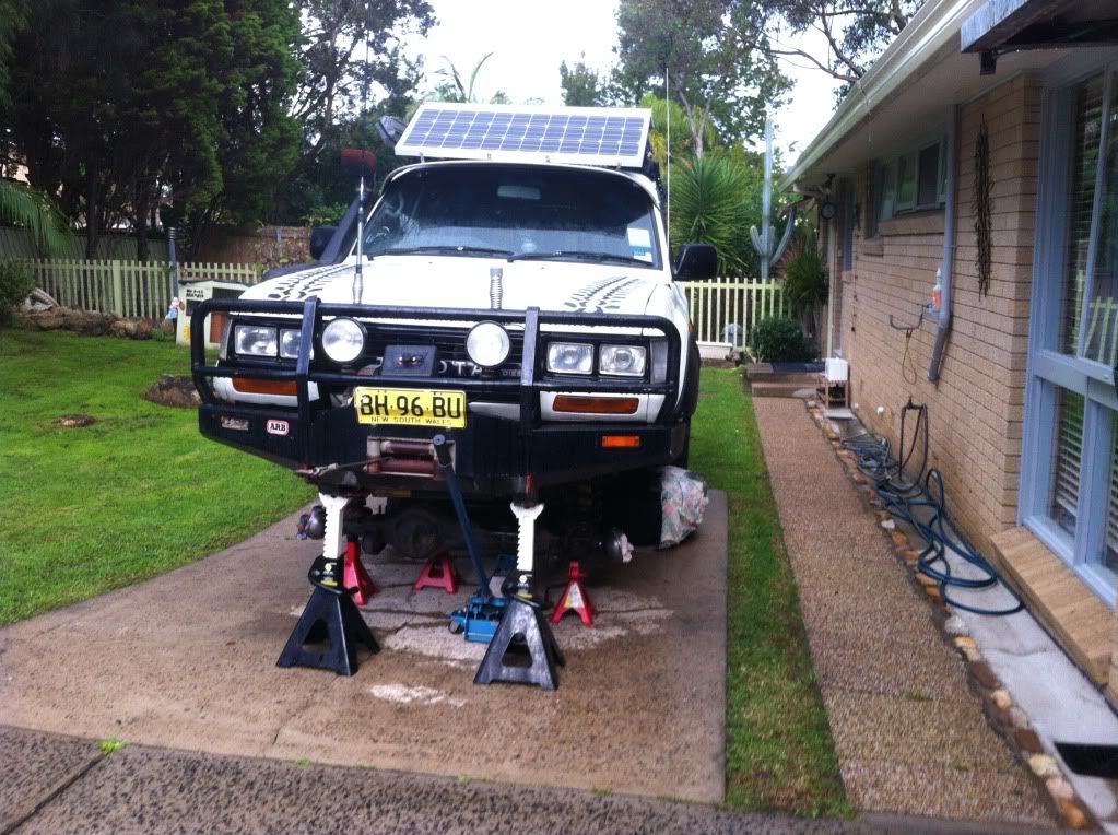

Ready to be sent off:

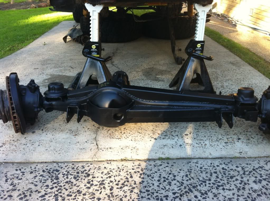

Back from the shop:

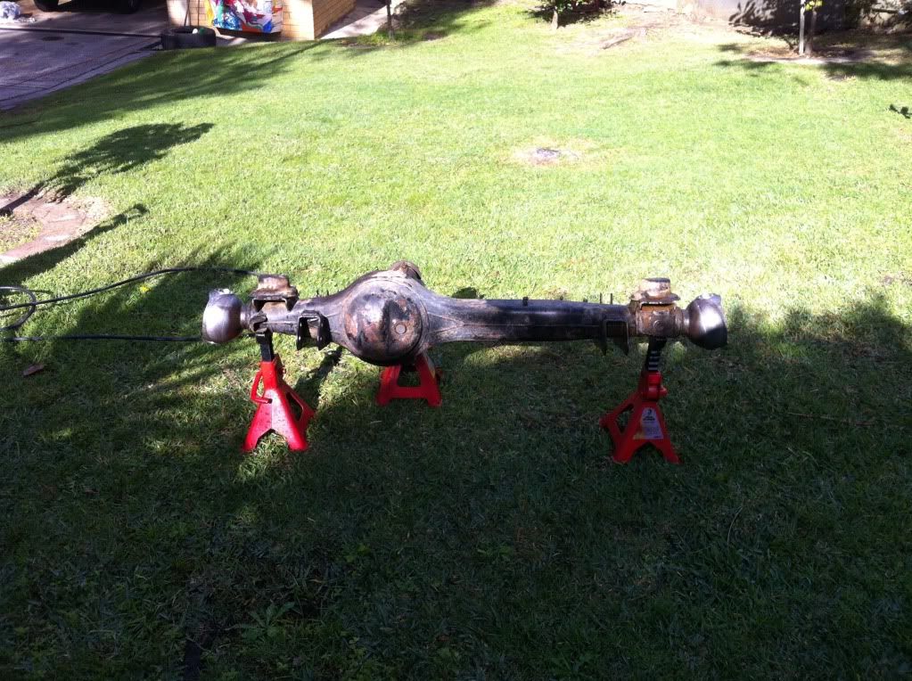

Back at home:
