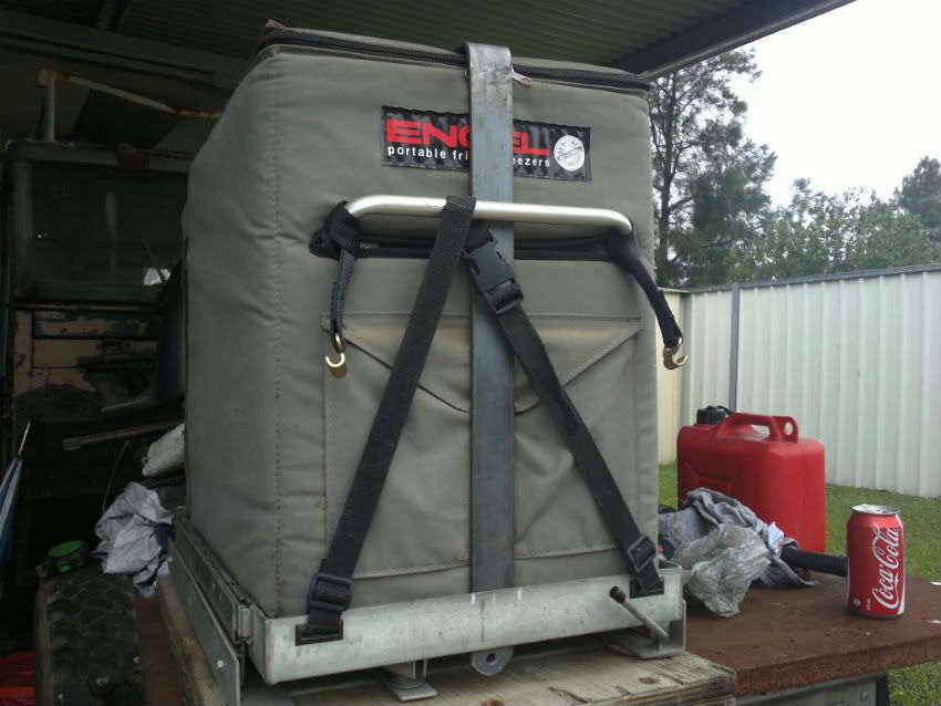

I bent a 50mm by 5mm metal strap around the fridge. I cut two slots into the bottom of the fridge slide so the strap pokes through. Put a padlock on both ends of the strap and its locked. I also welded a few links of chain to the slide so the front lock also hooks through the chain to stop the fridge from being able to be slide out. Then i mounted the slide on the tray and welded the ends of all the bolts. It aint coming off. It lives on the back of the lux now.

wow thats a good setup. I also like the idea of running a tap at the bottom of the fridge. both are very good ideas.

ERASER wrote:I bent a 50mm by 5mm metal strap around the fridge. I cut two slots into the bottom of the fridge slide so the strap pokes through. Put a padlock on both ends of the strap and its locked. I also welded a few links of chain to the slide so the front lock also hooks through the chain to stop the fridge from being able to be slide out. Then i mounted the slide on the tray and welded the ends of all the bolts. It aint coming off. It lives on the back of the lux now.
Mate, isn't this a pain when you want to stop and grab a drink or something out of it? Having to undo both padlocks and take the bar off?
