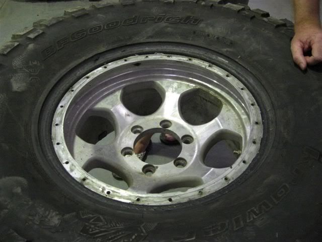

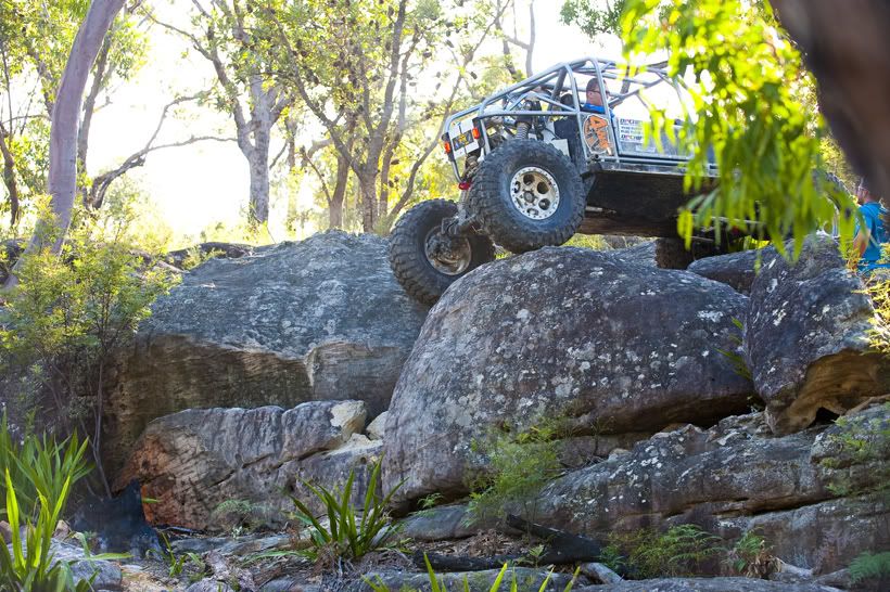

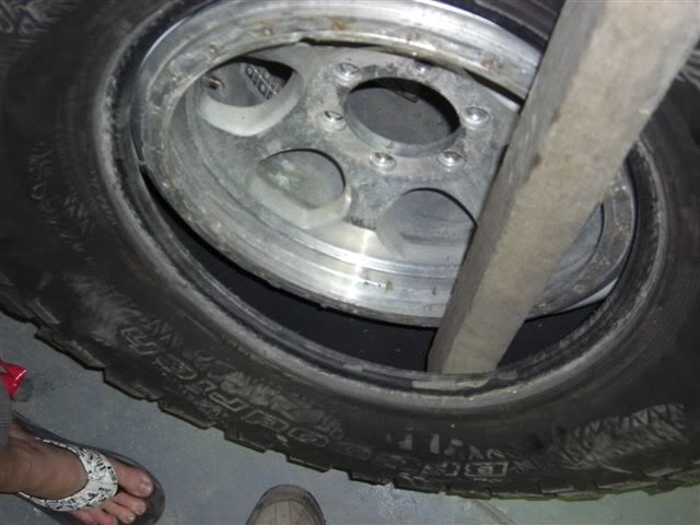

Removing the beadlock ring on the front wheels in preperation so add weight to the front tyres. Why add weight? So you can do this...
The added weight puts extra ground pressure on those front tyres, which equals a surprising amount of extra traction.

A high-tech piece of wood is used to make the room for...

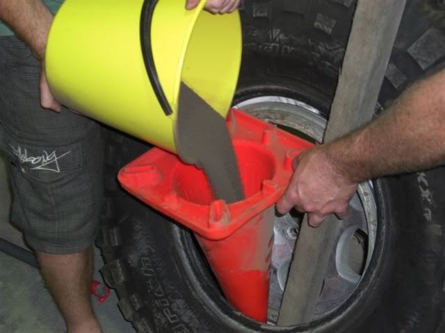

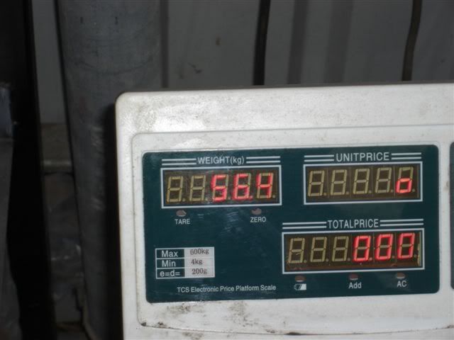

The high tech funnel! A mixture of steel shot and graphite powder is used to add the weight.

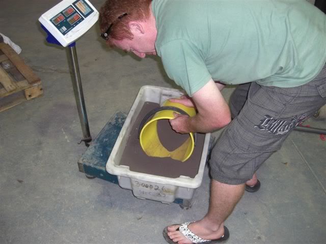

Of course the material is carefully measured to ensure that each tyre receives the same amount. From memory the boys added approx 50kg to each front wheel. Mal may be able to clarify.

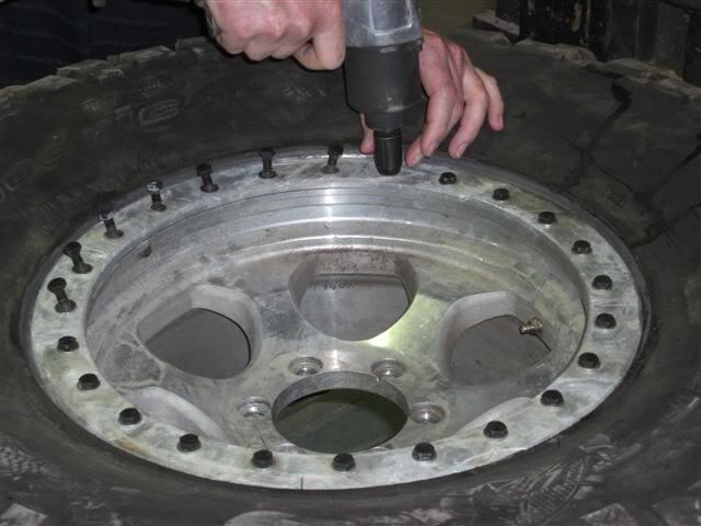

Beadlocks are great... until you have to remove and refit them!

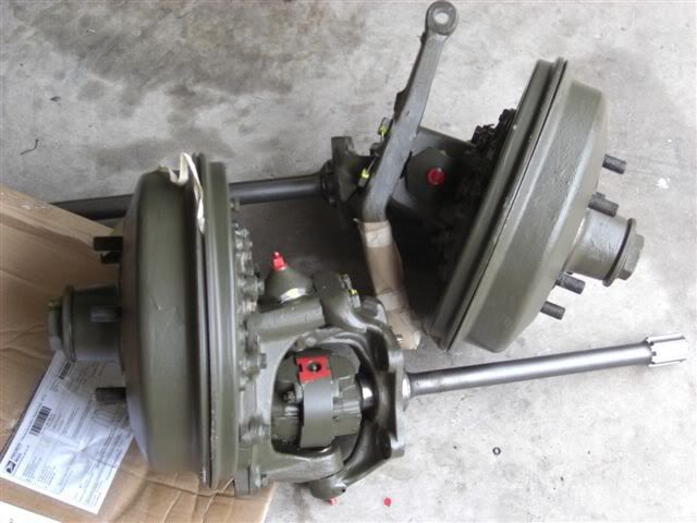

When Mal talked about maintenance and freshening up the front diff, this is what he was talking about. Brand spanking new Unimog portal boxes! Of course these ones will need a few minor alterations before being fitted up, but that is all a part of the fun!

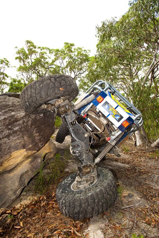

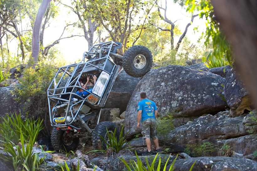

A couple of pics from a recent practice session. The boys will mark out courses and attack them under full comp rules and times.

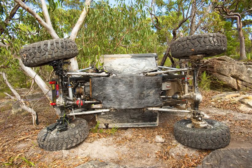

During these sessions, Mal will often push the envelope, just to keep it fresh in his mind exactly where the point of no return is. How do you figure out where that point is...
By going beyond it!
Perhaps we should have made up some Extreme stickers for the underside! The bummer about this roll was that the roll cage and barwork had all just had fresh paint put on the weekend before in preperation for the show'n'shine. By the time you are reading this, it will all be as-new again!

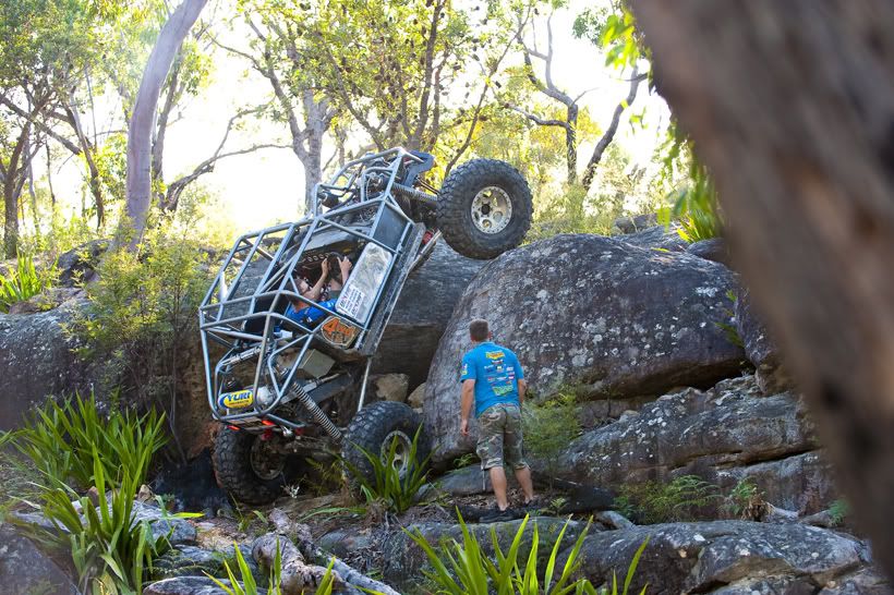

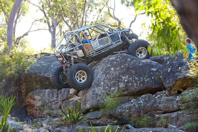

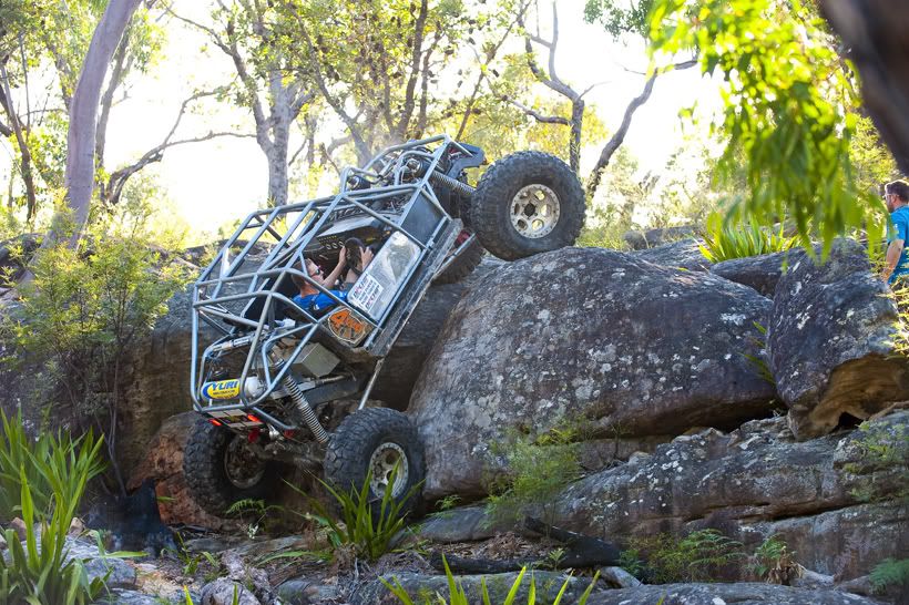

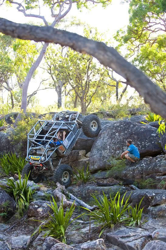

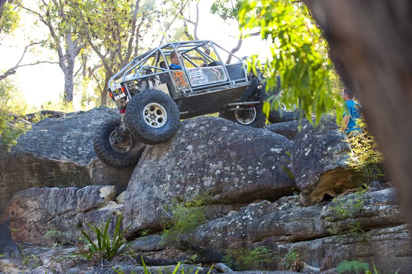

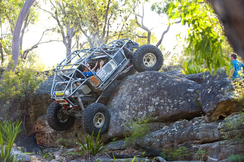

To finish things off, check out this awesome sequence!
Too easy. The competition had better watch out, Team Extreme 4WD Magazine is looking good for this years title!!

Love it Rick, great pics & god damn !! I didn't think they put that much weight in the tyres. I thought about 20-25kg, good to know.
