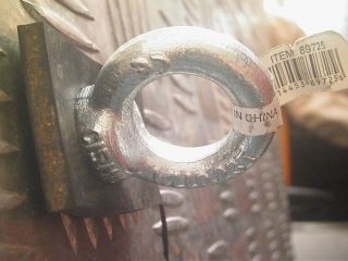

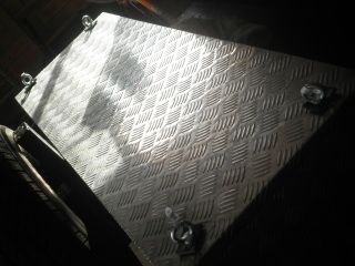

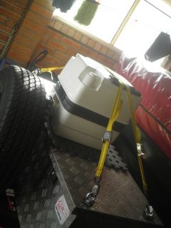

I had just bought a porta potti and wasn't to keen on keeping it inside the trailer. I had planned on putting it between the ally box and the body of the trailer but, unfortunately, it didn't fit there.

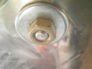

I'm not too sure why I put the rubber there - I'll probably take it off and put a second big washer on top so that I can get more of the nut on the thread of the eye bolt and thereby hopefully spread the weight over more of the surface of the tooll box lid
I'm going to get some more of the eye bolts is a smaller size so I can secure my 2 stroke fuel can on top of the wheel arch - the opposite side to my tool box

Did some more work on Katie last night. Just added some brackets to the tool box lid to securely locate the porta potti. The brackets were off my last ironnman awning so they should not be taxed too much by the weight of the throne
Drilled the 4 holes, threaded the bolts through the brackets, put some sikaflex on the bottom of the brackets and the on the mudguard washers underneath, all followed by a spring washer and a nylock nut. Hopefully this will stop the water ingress
Then I cut up a floor mat to go over the brackets which combined with some rubber on the upright part of the brackets should stop any rubbing. It ties down off the 2 eyelets of either side of the toolbox
I think I'll go back in an tidy up the rubber on the brackets so it doesn't look so half arsed!
