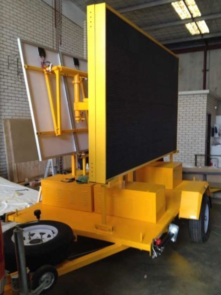

I've only built trailers in the past with square full length axles (45mm square) from Martins Trailer parts here in W.A.
VMS trailers like this one...
So I am keen to tackle a 3 tonne tandem tipper... to carry a pop top type camper when not being used as a firewood trailer.
