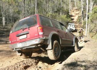

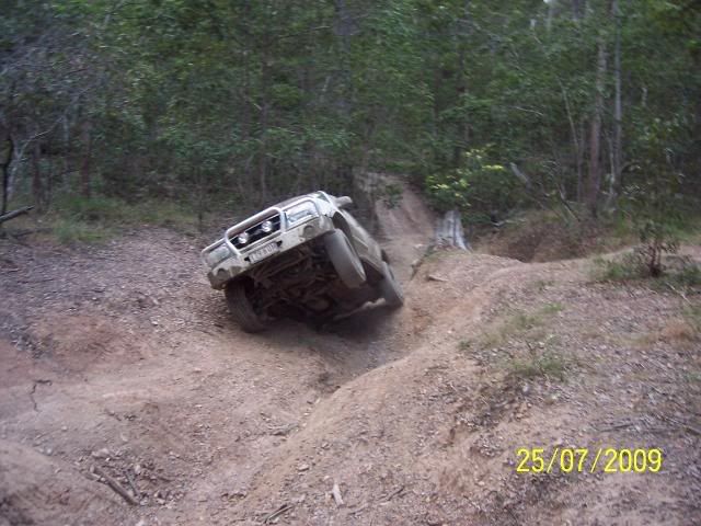

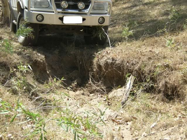

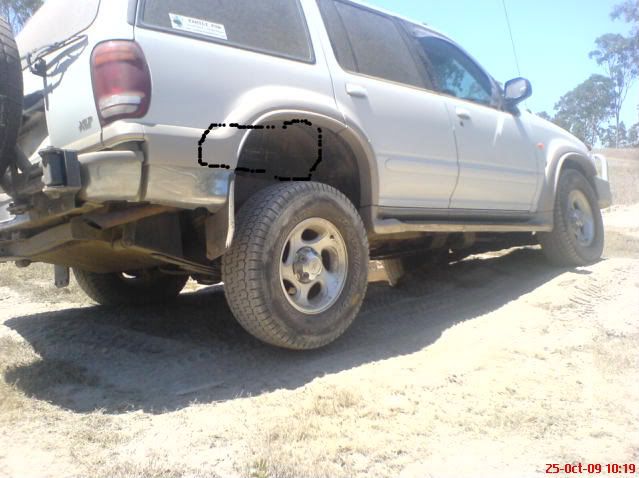

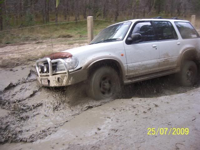

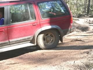

I've had a 98 & 2000 both XLT's, I modded both with just after-market suspension & off-road tyres & that was all they needed to keep up with any other IFS 4wd similarly done. The 4L petrol motor is strong in low & high ends but that said the series ll (96 to 2001) motors have one major drawback - they have TWO timing belts, front & back of motor, which is expensive every 100 000 to 140 000klm's. 1 lesser draw back is their air intake is behind the driver-side h/light & UNDER that is the relay box that controls a few important things like the alarm lock-up which when it gets wet just freeze's your car up completely e.g. steering lock, auto box gear change, ignition etc. This can be fixed by moving this relay box, standing it vertical (so any water drains out) & wrapping in plastic bags as I did.
All these pics I managed to get threw without help
I now own a Patrol but the X's are a VERY VERY underrated 4wd
