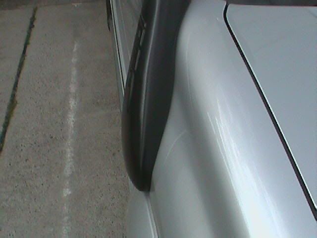

How is your cruise control in the way? Mine is mounted over the passenger side and all the XL-7 snorkels I've seen are mounted on the driver side where the airfilter box is.
eg. Offroad
David.

thanks for the tips, however, my cruise is certainly fitted on the driver side, together with the ABS system - I could move the cruise I suppose, but the ABS is hard plumbed - neat looking fitment in those photos - many thanks:crazy:

to my info the airflow snorkel goes into the engine bay at the back so it only fits GV/XL7s with no abs and it was not made for them in the first place.
This is the only snorkel in Aus that fits every GV/XL7....
I would love to see a PIC of this snorkel if it is not by airflow??
I just tried to get a pic of the airflow snorkel for the gv and it seems they do not do it anymore?? :p
Ps. the white XL7 is from the Nsw Suzuki club and others in the club also have this snorkel.
