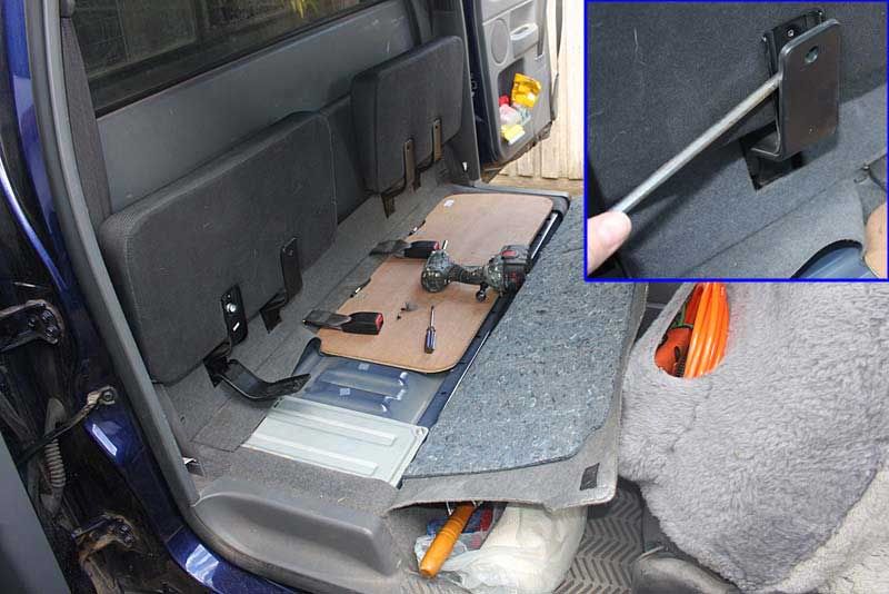

Step 1:
Start by undoing the little phillips-head screws on the underside of the seat cushion brackets. Then using a flat-head screwdriver if need be, pop the plastic fold-down cover of the bracket (see inset) to reveal the seat cushion retaining bolts underneath.

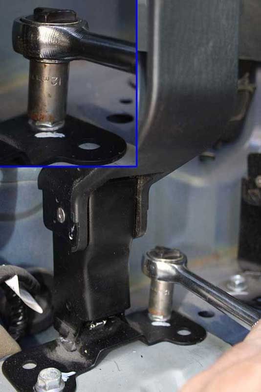

Step 2:
Now using a 12mm socket or spanner, remove the seat cushions by undoing the bolts retaining them and set them aside. Then fold down the spring-loaded brackets so they sit flat to the floor.

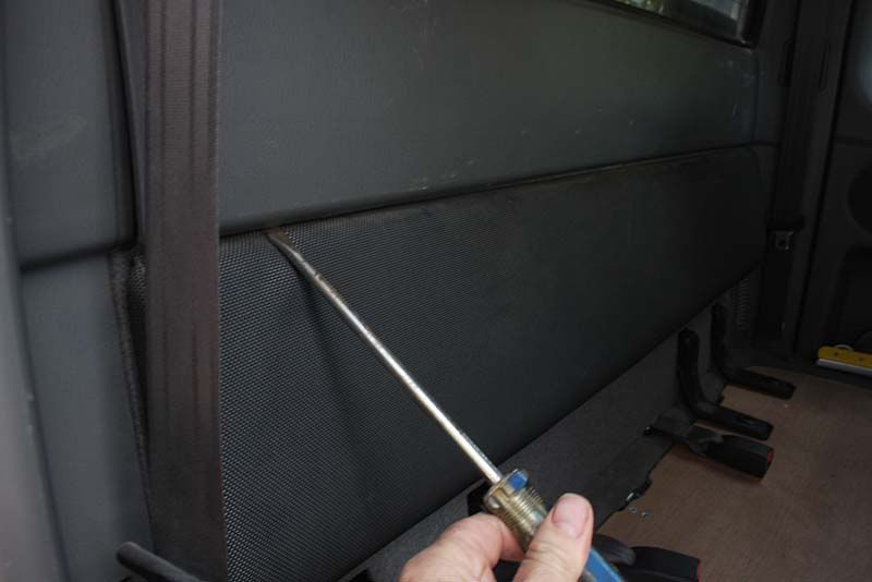

Step 3:
We now proceed to removing the plastic headboard above the center cushion. Do this by inserting a flat-head screwdriver under the headboard as shown in the photo below and then gently levering the plastic upwards. Once you have enough gap to get your fingers behind, you can then slowly pull the headboard off or keep working it off with the screwdriver if you prefer.
Note: This process can sound rather gruesome, like something is snapping that shouldn't be; rest assured this is normal. See the two insets in the photos below for what the retaining pins look like.

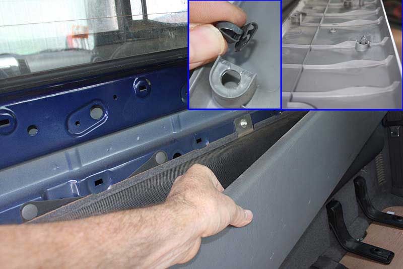

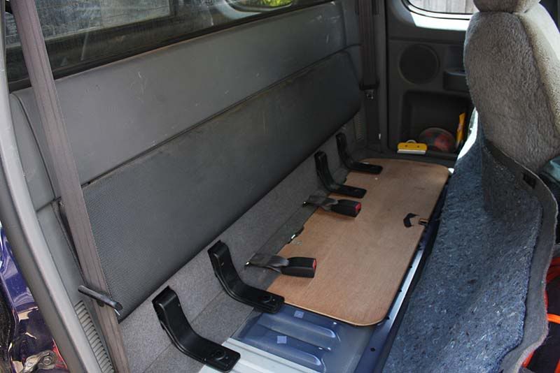

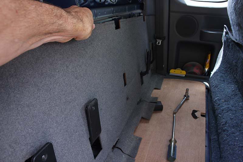

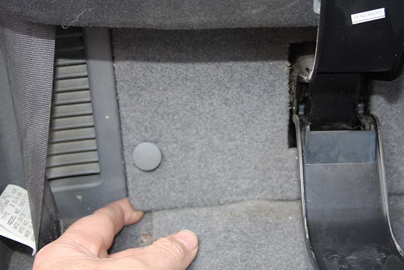

Before we pull off the masonite backing panel to access the bolts that remove the seat cushion brackets, we have to just pop out the three little retaining pins along the bottom of the panel as per the photos below; now would also be a good time to spring the seat cushion brackets into their upright position.
I found the best way to pop the retaining pins was by just grabbing the lower part of the carpet/panel and giving it a swift tug where the pins were and they just popped.
Once these three pins are popped out you can then go about removing the masonite panel and setting it aside.

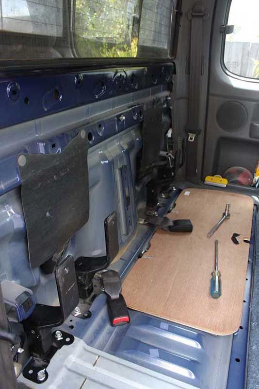

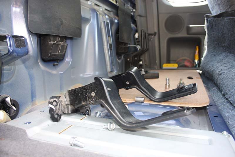

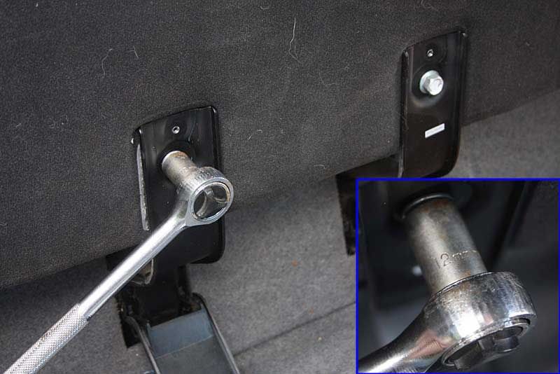

Step 6:
And the rest is history she cried. Using a 12mm socket/spanner you can now undo the retaining bolts that hold the fold-down brackets in place and remove them.
You will also notice that Ford in all of their infinite wisdom have even placed white marks on the brackets where the bolts go so that when/if you reinstall them you won't forget which is which — how thoughtful of them lol.

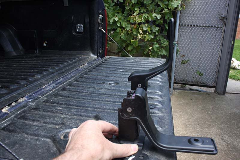

Other uses for the fold-down brackets:
A fold down shelf in the tub maybe?
Or on the tailgate? The possibilities are endless ;)

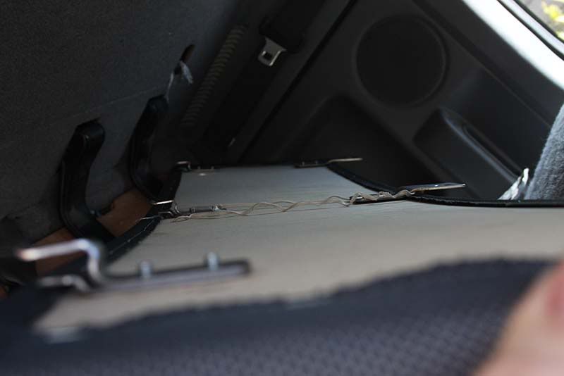

I realise this thread is a bit old but I just thought I'd show you how I finished mine off with a piece of 6mm marine ply, couple of coats clear lacquer.
Keeps a lot of road noise out but does not interfere with cabin flow through ventilation.
