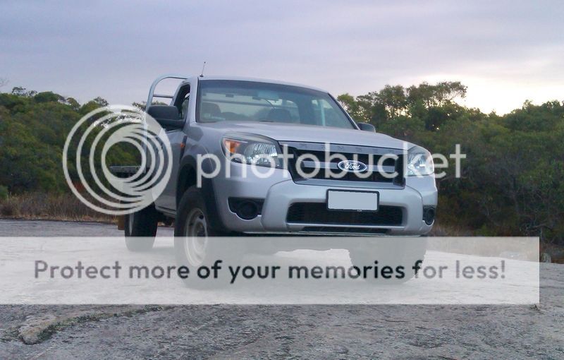

Just for general info, yesterday fitted second hand rims (CSA Jackals 16 x 8's) with near new GY Wrangler Duratracs (265/75).
The rims were +35 offset, so was a little concerned about that, but all good with 6mm spacers to front.
Tiny bit of contact on front skirts (both sides) when full locked, bit of hammer time and black spray pack today, all fixed.
Could have easily stayed +25 or even +20 and still been inside the wheel arches, though might have rubbed on wheel arches then perhaps.
Pic of new wheels / tyres alongside existing factory 15's with factory 235/75 AT22s.
Already had small lift front and rear, wound up LH HD torsion a smidge to rematch RH side, ended up with :
Ground to under centre of front wheel arches, was 870mm, now 925mm.
Ground to under centre or rear wheel arches, was 895mm, now 940mm.
Clearance under rear pumpkin, was 195mm, now 242mm.
So, off for a wheel align and balance tomorrow.

That looks really good mate!
It's amazing how much different your ute looks with the bigger tyres on it.

Ta mate, yeah, very happy with the wheels look, suit very nicely.
Just going to love the extra clearance and traction.
WA went ok today, they had to shim both sides a little, but at least now it's fully alignable.
After the initial lift, the RH side was 0.5mm out (camber + or - I think it was), but was so close left it and just rotate every service with no noticeable wear.
Now, they will be rotated same anyway, to ensure I get the most out of these wider ones.

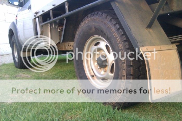

Finally changed out our tyres. 265/75/16 Kumhu ATs on the stock PJ XLT rims, stock height with some tweaked torsion bars, not to much though. I have taken the small section of of XLT mudflap off of the front and then trimmed the rear of the flare so its no where near the tyres.
