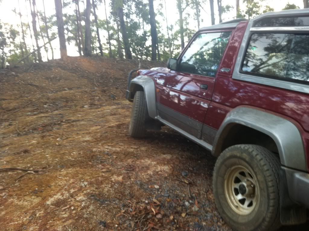

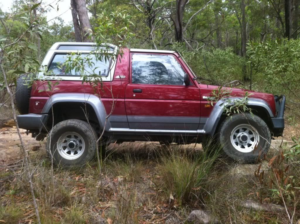

Ahhh jennyrebel, the Rocky.
I've got an F78 as well. I have a pretty good whine coming from my gearbox. I have read elsewhere that it is a pretty standard thing. Mine only comes in over 85km/h. To be honest, it could be the transfer case. I just know it is there. Gearbox is great, so I just live with it.
Where did you get the spare box from? My rear diff went, and I couldn't find a replacement for the life of me. Tried just about everywhere in Australia. Got it rebuilt in the end. $2,500 all up. That included a new brake master cylinder and wheel cylinders. Had to get them from the UK, as they're not anywhere in Australia. Really good mob, milnersoffroad.com. Got the master cylinder delivered cheaper than a mob in Coffs Horbour wanted to repair it.
The rear brake shoes are a hassle to get as well. They are a strange code... I have all the info still if you ever need it.
I should probably start a thread on parts for the F78. They're pretty rare, and one place with good info can't be a bad thing!
Hope you dont have any more problems! They are great little beasts.

your Rocky looks in really good nick - nice! Well I'm taking mine back to the transmission mechanic tomorrow because they repaired the gearbox, not rebuilt or anything, for $800 but it's still leaking. As for the whine, mine seems to do it right from the start, and I'm not sure if its a bit worse since having the gearbox looked at or whether I just notice it more. I also seem to get a lot more vibration now so I'm not sure what that is.
