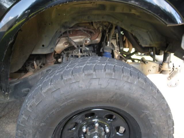

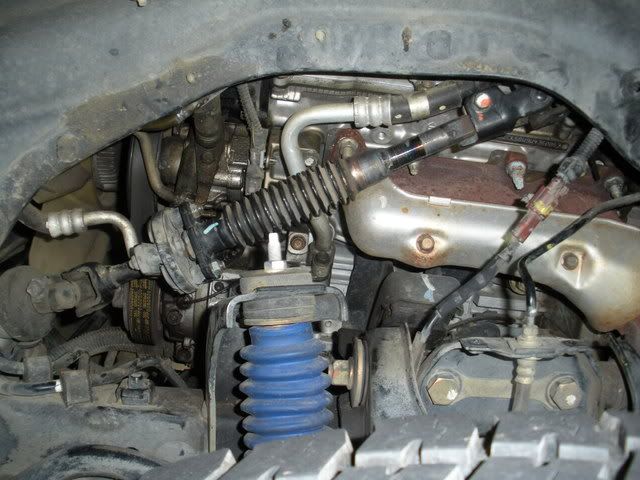

Gday mate ,hope your keepin safe.What size engine do you have petrol(gas)/diesel and hows the fuel enconomy.When you did the body lift what did you have to lenghten / adjust, hoses,cables etc around engine bay .Was it a lota trouble. Cheers mate Dazme:D
Blackisuzu98
Posts: 16
Joined: November 2nd, 2009, 9:45 pm
Location: Ridgeland, MS, US
Unread post by Blackisuzu98 » April 9th, 2010, 5:15 pm
I have the 3.2L Gas V6, the mileage isn't too bad considering the added weight from the ARB and my full size spare on the back. I'd say it's between 16-19mpg depending on how i drive. On the highway it's been getting pretty close to 21mpg. The snorkel has helped alot.

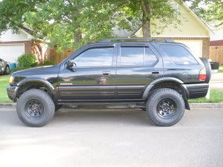

I did the body lift back in June of '09 right before we deployed over here, wasn't too bad of a job. Got it done in right at 5 hours and i was by myself. As far as hoses and lines, all i had to extend was my steering shaft. You have to weld in a 1" extension to the shaft right before it squares off at the end. The fuel line extended fine, all you have to do there is remove the bolt that holds the line to the frame. With the radiator, some choose to relocate it 3" lower, it's not necessary with our Rodeos/Fronteras, you can let it raise with the body that's what i did and still haven't had any problems. Here are the few pics i have of the body lift install.
If you look close you can see the "grayish" extension in the shaft.
Before the body lift
After
