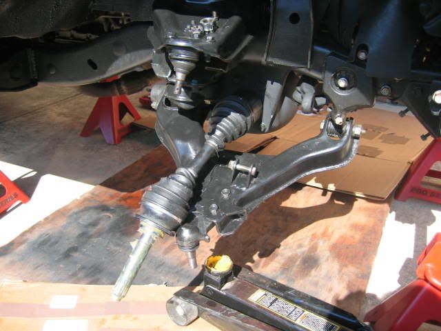

have a squiz at the photo- it's taken from behind the drivers side tyre
jack up your fronty *both sides*, lock the hubs (if needed)
does the other tyre turn?
does the CV turn?
does the hub have that "click" and firmer feel when you lock it in?

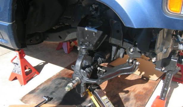

here is a photo of a jackaroo (close enough to the same suspension) can you edit it in paint and draw an arrow to wear you think the sound is coming from?
(also a thread to get you drooling)
Planetisuzoo.com :: View topic - 2nd Gen Trooper Monster IFS Build Thread - 35's & Locker
if the other tyre turns, the CV isn't broken.
by the sounds of it, it's a dud bearing
