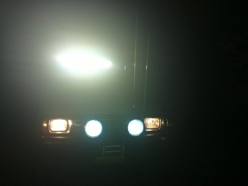

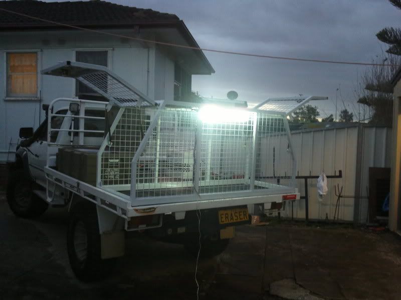

Re: What are peoples opinions on lights - LED or HID?
Unread post by ERASER » July 7th, 2012, 10:39 pm
Yeap combo of light bar and hid spotties is the ultimate. I run a 42 inch light bar up front with hid spotlights. I also run a 22 inch light bar on the rear, works a treat in the bush......
